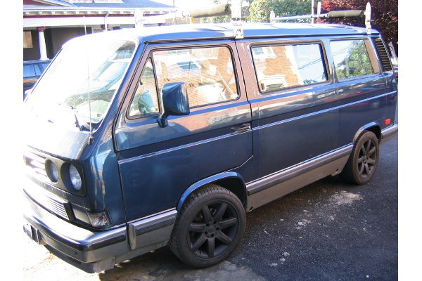

I'm looking for some first hand expeience with Koni front shocks. How do they ride? Is there enough adjustability to allow for the "perfect" setting?
Are they any shorter than the OE shocks?
Right now I'm running a set of Bilsteins that were originally meant for the front of a Chevy S-10. I modified them to mount to the Vanagon and have been very happy with the ride up until lately. I lowered the van about 1" more and now I need to find a stiffer shock to go along with the stiffer spring rate. I can't use OE length shocks due to how low the van is.
I know that there aren't too many performance oriented Vanagon owners on here, but any information would be helpful.

Sweet. Sorry I can not offer shock advise. But that looks good.

Your van looks sweet btw
