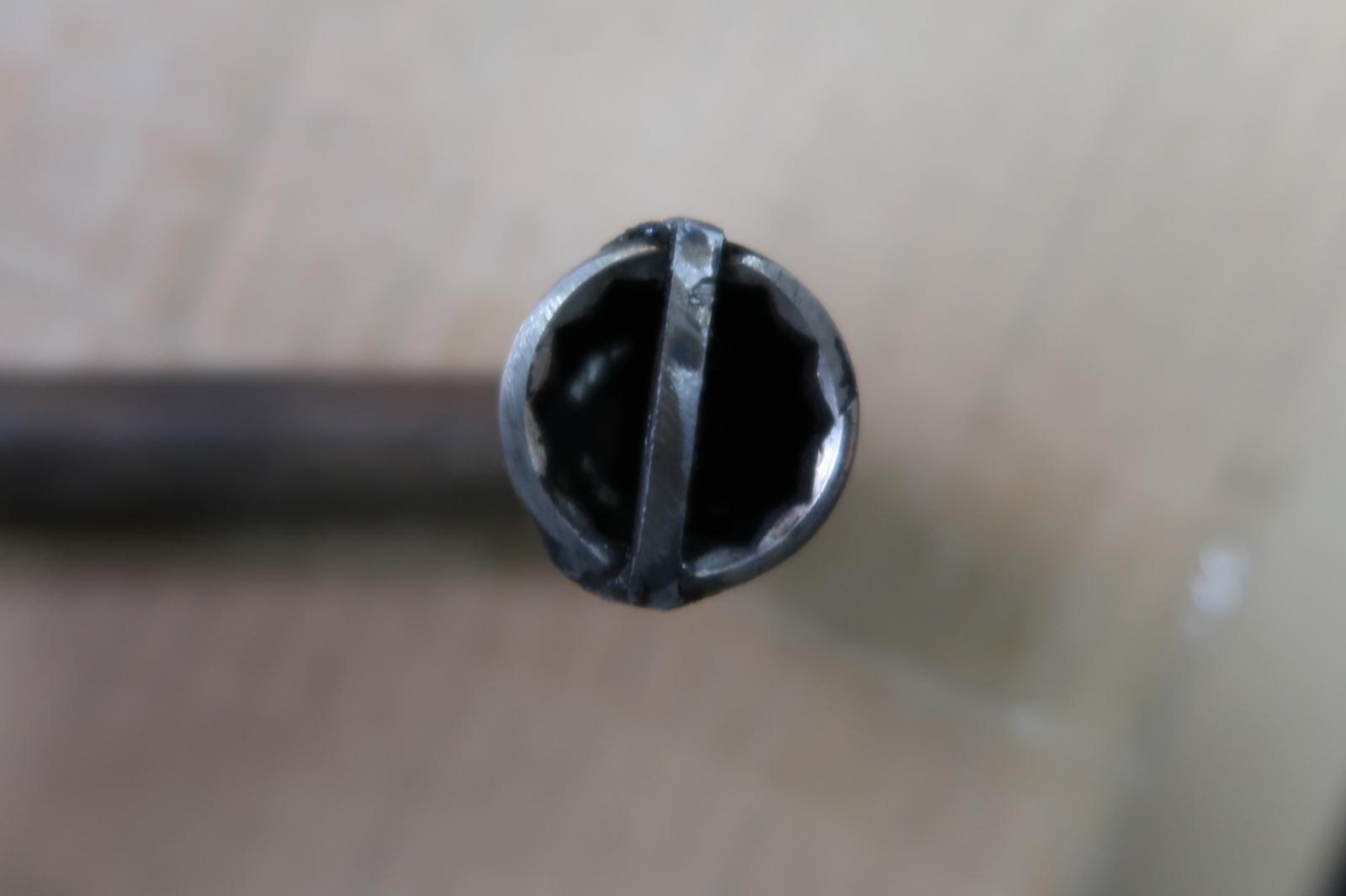

PostPosted: Fri May 24, 2024 1:23 am    Post subject: Re: Recommended tool to remove oil pressure spring plug Reply with quote
I made this for many years and it´s allway work.

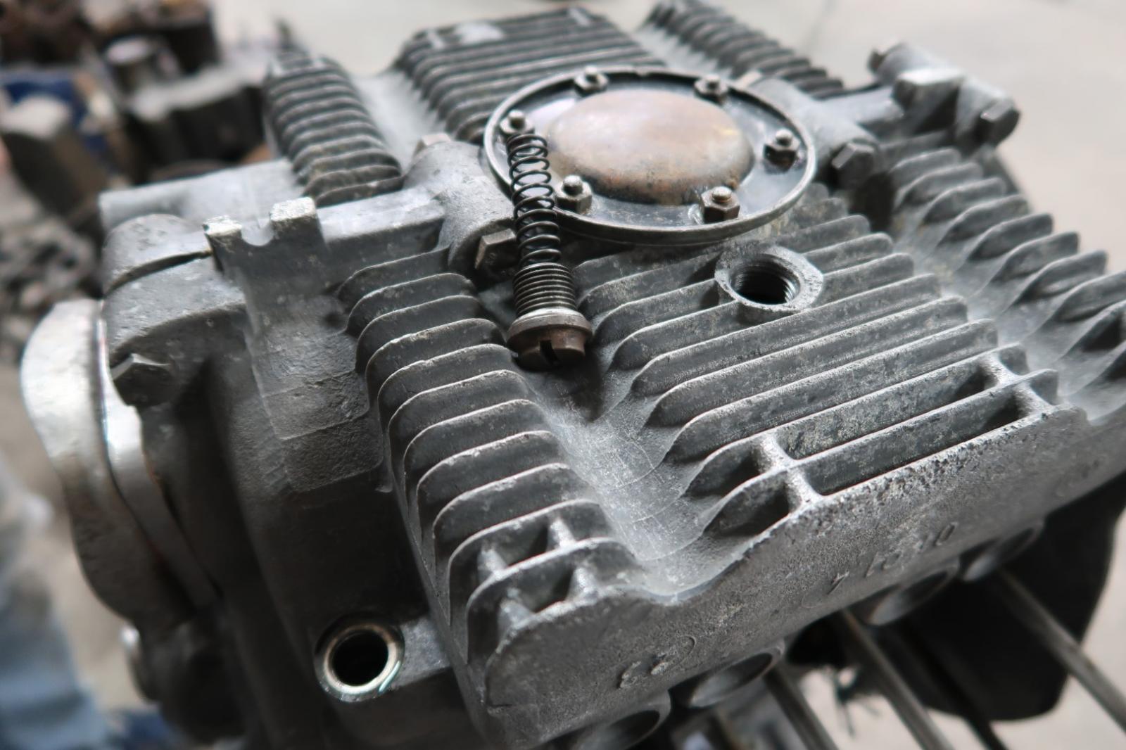

PostPosted: Mon May 27, 2024 4:23 pm    Post subject: Re: Recommended tool to remove oil pressure spring plug Reply with quote
UPDATE - this drag link socket worked perfectly: https://www.amazon.com/Stanley-Proto-J5444A-2-Inch...amp;sr=8-2
I was able to successfully remove and install the plug and replace the spring and plunger.
