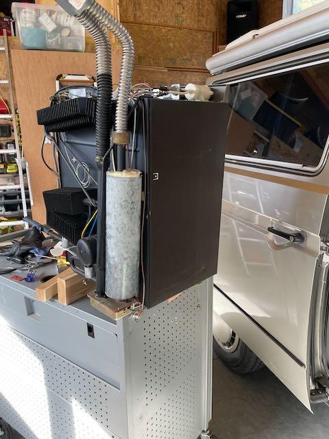

PostPosted: Sun Oct 20, 2024 3:36 pm    Post subject: fridge pain Reply with quote
So , my Dometic works on A/C or D/C and when the unit is out of the van with the burner box opened it easily starts on propane . Igniter ,thermocouple all seems to function perfectly. When I close the burner while it is lit ,it remains lit.
It does restart if started within a very short time, but after refuses to light. I have tried everything suggested here and have checked all pipes and potential blockage. It would seem that it needs more air. I know this might suggest some sort of air blockage but every flue and intake including the drain has repeatedly been checked. Is there something I have not thought of? I have even tried adding extra air and oxygen into the intake and drain pipe Help!!! Has anyone else experienced this?

PostPosted: Sun Oct 20, 2024 3:41 pm    Post subject: Re: fridge pain Reply with quote
carboy1953 wrote:
It does restart if started within a very short time, but after refuses to light. [/img]
it is VERY common to have to start the fridge on 120v or 12v to heat up the exhaust. this establishes a convective air flow that allows the propane to light easier. so... the 64 dollar question is, when installed, have you tried running the fridge on 120v for several hours and THEN lighting the propane?
the propane lights easily on the bench because you do not have the exterior baffling trim plate in place... just two big o' round holes that breathe nice.

PostPosted: Sun Oct 20, 2024 8:42 pm    Post subject: Re: beating a dead horse, er, fridge Reply with quote
Thanks Dan , but the problem is even though the fridge is out of the van ,it still will not fire up unless I separate and open the burner box from the intake/exhaust flues. . perhaps I should try running it on A/C for a while and see if it would start. I get your point about the air circulation. I thought that blowing air through the drain might do the job . I even tried forcing some air through the intake with a reversed vacuum cleaner.This is a very low mileage little used 1988 with about 70,000miles. Most likely used very little . Everything was very clean and tidy when I removed it from the van.....Frustrating

PostPosted: Mon Oct 21, 2024 4:59 am    Post subject: Re: beating a dead horse, er, fridge Reply with quote
How is your propane supply connected when the fridge is in the van or on the bench? I'm wondering if the propane pressure delivered by the regulator(s?) is up to spec of 11" water column.
Propane regulators can wear overtime and deliver lower pressure than spec. This can be measured using a gauge or manometer. Most regulators can be adjusted to deliver pressure to spec. Info on a home made manometer:
https://www.thesamba.com/vw/forum/viewtopic.php?t=726525
If you're using different regulators in the van and during the bench test it doesn't seem that this is a likely problem (hopefully at least one is up to spec) but it may be worth checking given all that you've done to correct the problem.

PostPosted: Mon Oct 21, 2024 8:51 am    Post subject: Re: beating a dead horse, er, fridge Reply with quote
thanks Jim, the fridge would not fire in the van but does fire on the bench as long as it has the burner box slightly open. Is it possible that if the BQ regulator were not to spec that this could make a difference lighting as to air /propane mixture?
