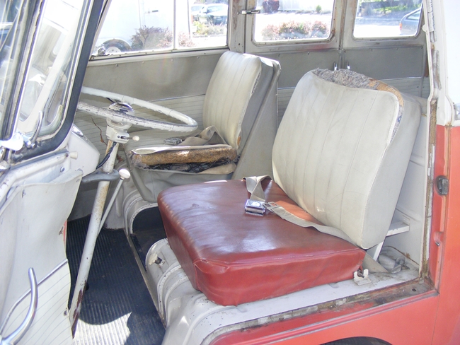

That seems to be true based on this photo:
It sounded like the seat was the same size but was moved over closer to the door. I'm guessing it's still not the best experience since you are sitting on the right edge of the wider seat and/or leaning to the right to get centered over the steering wheel. Your Chiropractor would not approve.

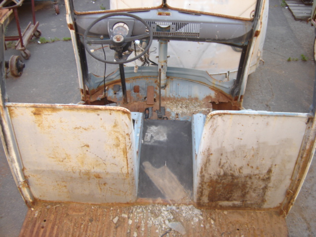

I wonder if the seat stand width is any different. Here's an photo of an early w/t for comparison:
olliehank47
Joined: May 04, 2011
Posts: 1198
olliehank47 is offline
PostPosted: Thu Jun 25, 2015 12:56 pm    Post subject: Reply with quote
I did a little "eyeball" measuring on my 67, with the pic you posted. Looking at the side of the base, from the rear towards the gas pedal, you can see it lines up almost exactly with the bottom left corner of the gas pedal. My 67 base lines up exactly the same, and I'm sure the size of the walk through opening is the same. Additionally, on the 67, the bottom right rail of the seat base sits directly above the right edge of the base--it's moved as far to the right as possible without hanging over into the walk through gap. By the time the spring frame and covers are added, the seat back is a bit wider than the frame so the bulkhead is bulged so it can wrap around and be secured to the side of the base.

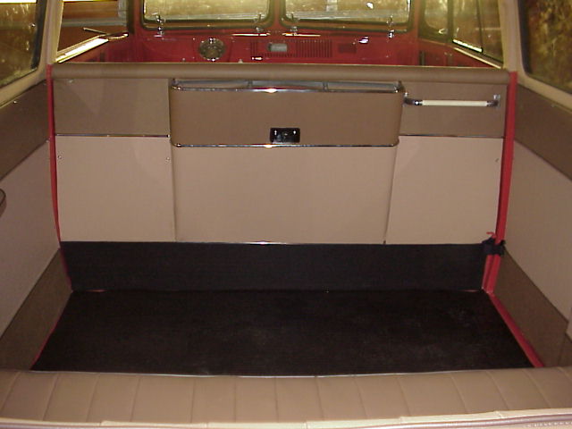

I have a 1960 with a bench seat and I was noticing there is no shelf on the left for my drink. Seat is also not adjustable. I've seen some pics where there are more than one slot for the seat bottom, mine is fixed. I assume those slots are for adjusting, not sure how that worked with the seat back on those with 3 slots.
Posts: 71518
PostPosted: Fri Jan 29, 2016 11:04 pm    Post subject: Re: Seat Position Reply with quote
1961-62 are the ones with the 3 slots for adjustment.
Example
The shelf aka drink tray is in the center behind the front bench seat.
Example
