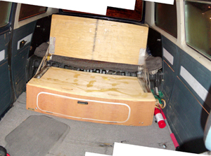

PostPosted: Wed Feb 15, 2006 2:17 pm    Post subject: Reply with quote
Deep_Blue wrote:
Do you have any pics, Coyote? I have seen someone lay a cushion on plywood and call it a bed in an 84.
I haven't installed the thing yet - I still have to redo the cushions and fabricate something for the back, because the Bays were apparently 3" taller back there...but here's a pic of the bed as it is now (it is in "bed" position, but the bottom seat cushion isn't attached):
here it is assembled:
Here you can see how it (not quite) fits into my '85:
...and here are more detailed pix of it:
http://www.peterbergin.com/?p=125

PostPosted: Wed Feb 22, 2006 6:46 am    Post subject: Got the zbed in there Reply with quote
Since I used a '68 zbed, the rear is about three inches higher than the rear deck. Depending on time, etc., I'll either build a little frame and have storage space for flat objects or just put another layer of padding there...but it's in:
