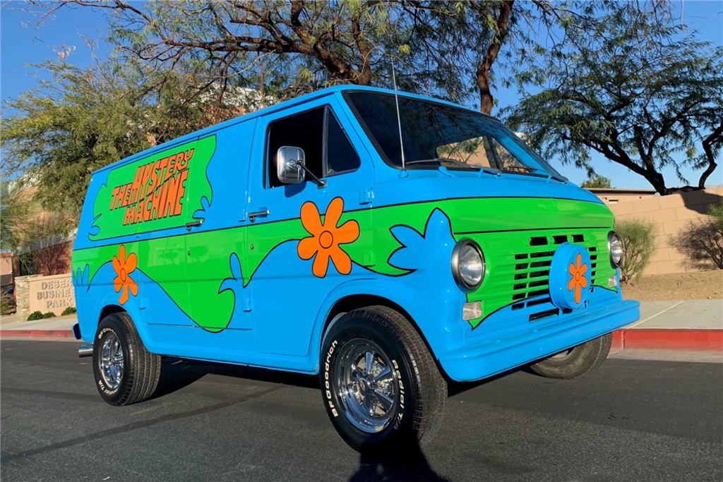

Almost any flatnosed van is viewed by the public as a VW anyway. People actually think the Scooby Doo Mystery Machine was a VW despite the radiator steam often present and engine in the front. And the 60s model Dodge, Ford and Chevies are much less expensive, already water cooled.
