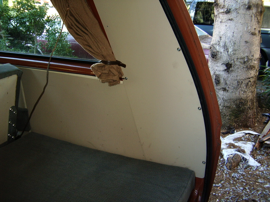

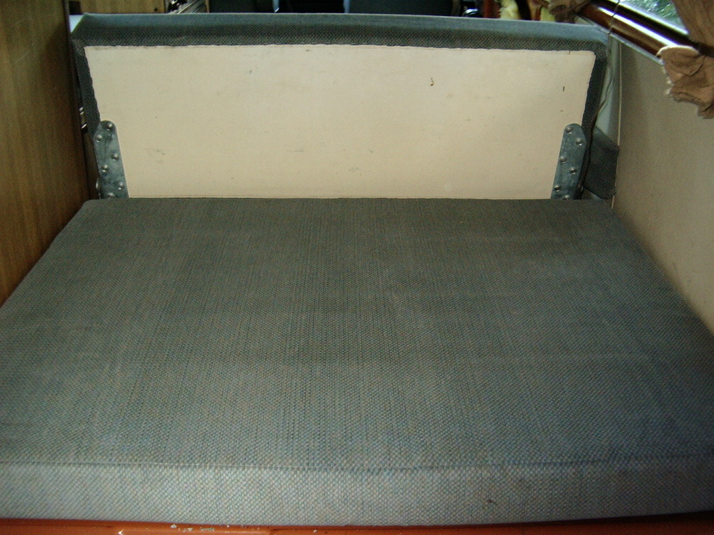

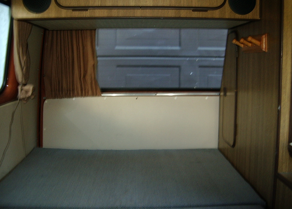

Here's what we did with ours:
Those are the new rear seat and sleeping cushion covers we had made at a local college. Really cheap. They were only $150 and are fairly professionally done. Good option if you're light on cash. Smile

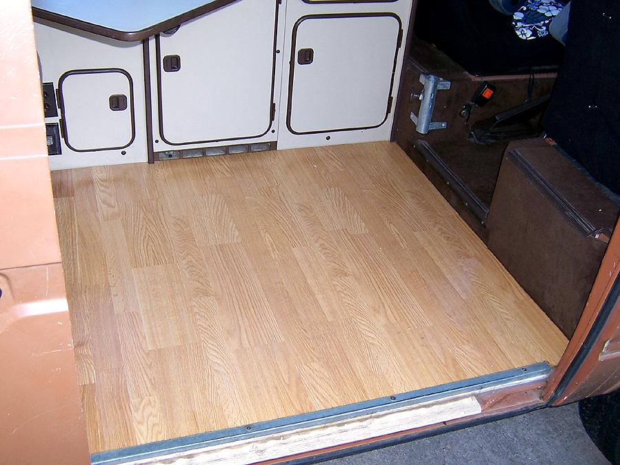

Those are the laminate click floors we bought from a local hardware store. $29 to do the whole centre section of the van. Dancing Easy to put in just remove your rear seat and start from the fridge side and work your way out. You've only got to cut about 4" off a full length of the stuff and they fit beautifully under the seat to hide your cuts. I used a chop saw for mine but they say you can use just a really sharp exacto blade. We were kinda worried about the laminate with the water but it seems to be holding up well. And if I may make a suggestion buy the $12 pack of wood flooring underlay. Didn't in mine and it's just enough insulation gone to make it really cold on the feet in the mornin. Brick wall We're going to have the front seats re-upholstered to look like the rears this summer. It takes a while so we're getting a set of donor seats in the meantime so we can still camp. Very Happy The only other interior mod we made was these ABS plastic panels I had a buddy make up for me. They look exactly like the originals but they are not paper covered board. Nice and easy to clean too. And relatively cheap. I've only done the side door and the rear hatch and engine compartment areas but there are plans to redo the whole van in it.

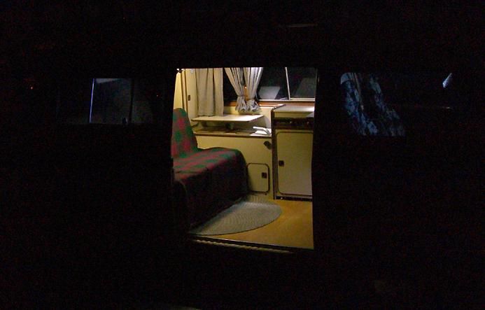

Here's the 'Pergo' floor Winston's previous owner, who did this sort of thing, installed in his central rear cabin:
I need to put some kind of wax on that to protect it somewhat, but it does look nice and seems to be standing up to my use well. The P.O. also had a semi-circular throw rug, which I've washed with a pressure washer and set upon a non-slip pad. You can get a look at that setup in this picture from my 'Illuminati' post:

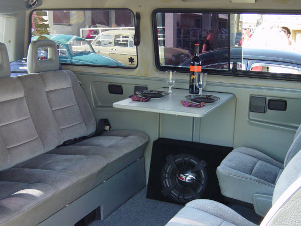

I have a "Wolfsburg" interior, not much customized aside from the stereo install, the sub can be moved to sit behind driver seat. These can sometime be found wrecked or salvagable and interior can be swaped in. If you don't require all the cabinet space and stove it is nice because it is uncluttered, the jump seats come out and the rear seat folds out into a QUEEN size bed, Just a thought. Good luck.
