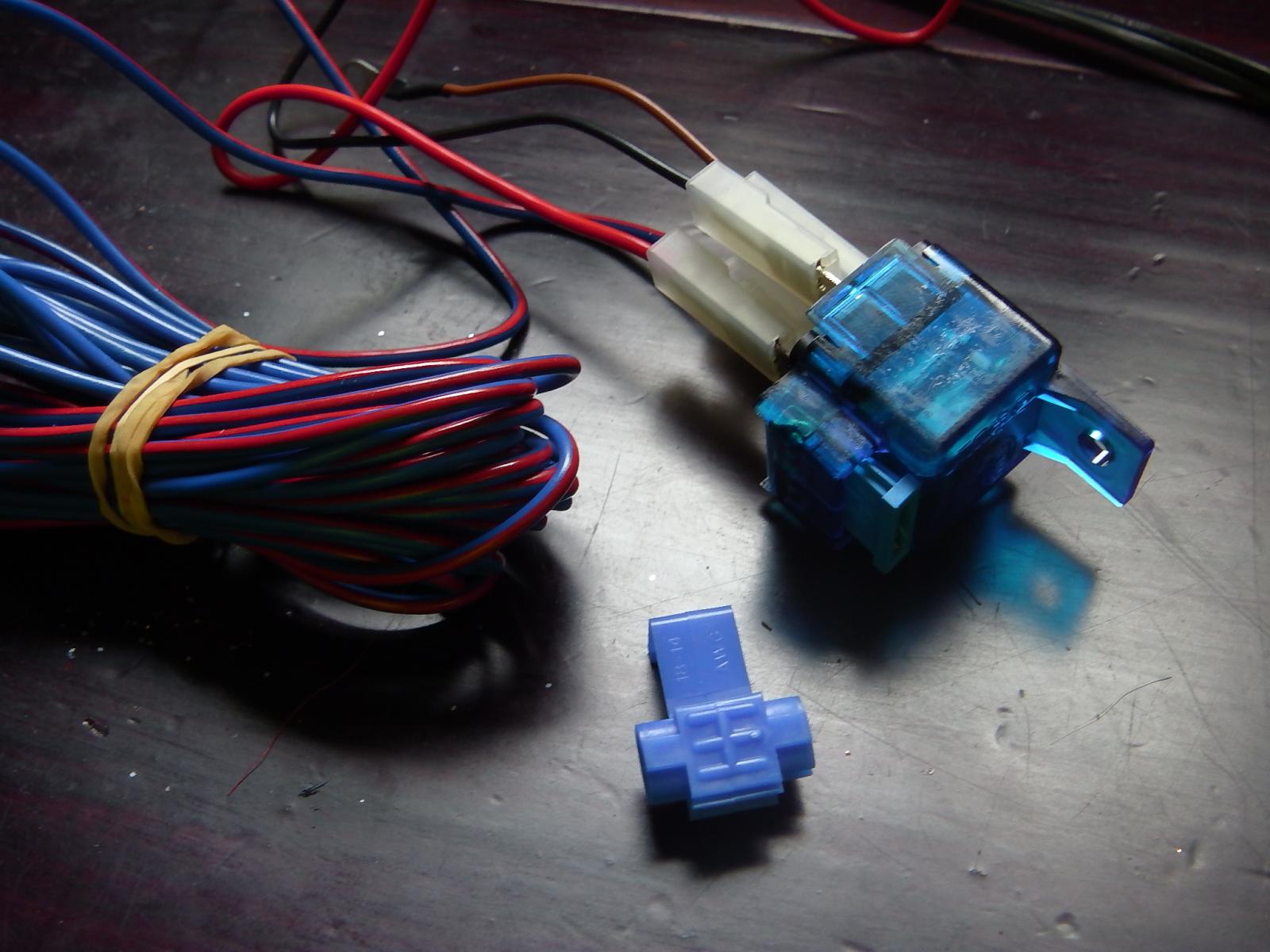

batteries are isolated when the engine is off by the cheapo unit below, but it works. ...yep 6 amps is what the charger puts out per bank. kinda marginal when camping, if i have access to electricity. i have it wired so that the exterior plug in goes to the charger and also to the original outlet

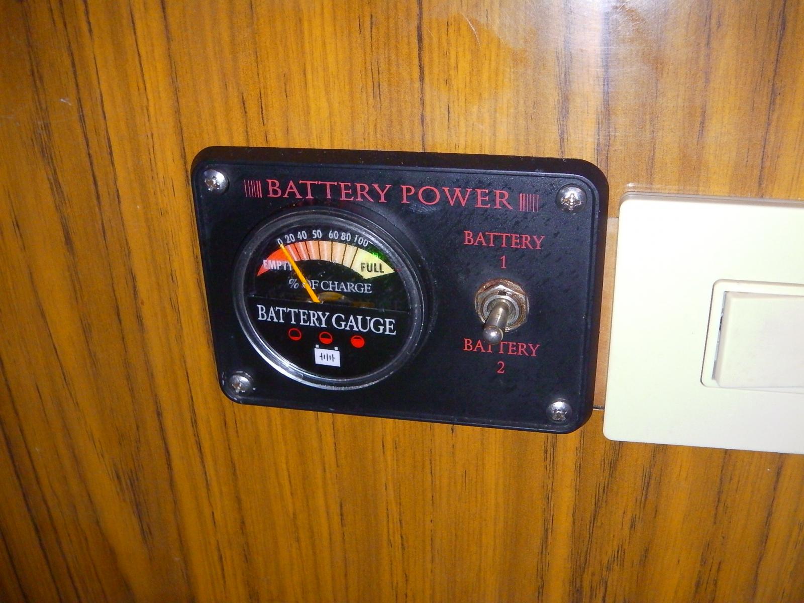

this is how i monitor the batteries. po had cut a hole in the cabinet so i used the gauge and the switch to hide it. switch goes to a windshield washer pump that i have running to the faucet

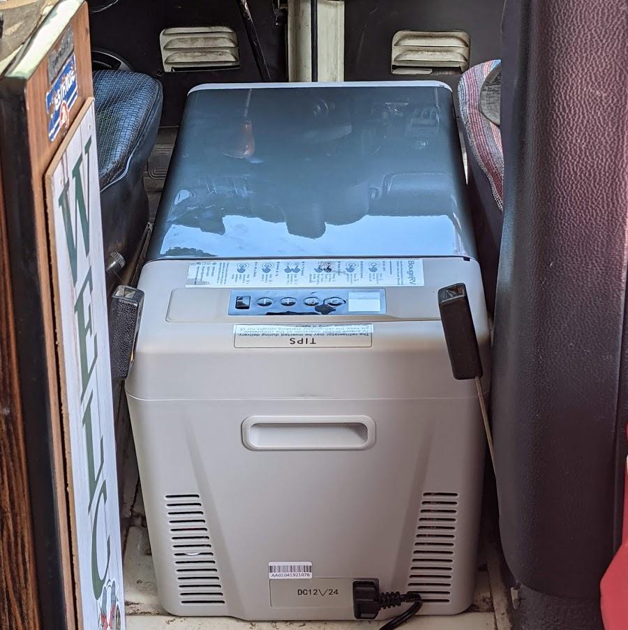

Got ours on Amazon for $199 (goes on/off sale) - Bouge RV 23qt. We have a 100w solar panel on the roof that charges a Jackery 300. Fridge runs indefinitely on solar, or 48 hours on the Jackery 300 alone.
Last summer, our bottles of water had ice crystals in them when it was 85 degrees outside. Highly recommended - fits exactly between the seats and 3 yr warranty.
