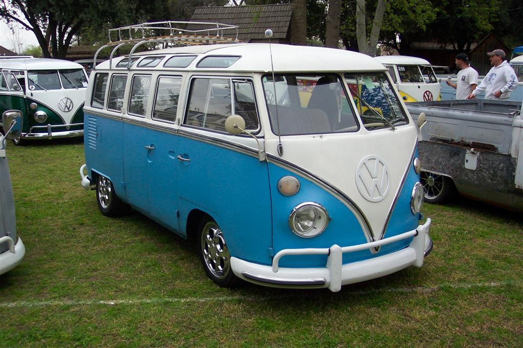

I have a set of Porsche chrome wheels (from a 912) mounted on my SC. The fronts fit just fine, since I have the 944 disc brakes on it. The rears are mounted with wheel adapters; however, I cannot get the hubcaps on. I have measured and it looks like I will have to grind off about 1/4" - 1/2" of the axle stub and nut to get them to fit. Anyone have a better suggestion? If I do grind them down, I won't be able to use the cotter pin anymore. I can't use wheel spacers, because with the adapters there is only about 1/4" of clearance between the tire and fender lip.

I have the same problem with my Phone Dials on the rear. I just go without the caps until I get the straight axle in. I know this doesn't help, but I couldn't find a better way on my bus and I too have only a quarter of and inch of space in the fender. I run Porsche turbo brakes in the front and adapters on the rear right now.

I noticed that the bus really "needs" the adapters in the rear, because the porsche brakes up front push the wheels out about 1.5" on each side.
Ghetto-style it is then, for now...blacked-out centers and chrome lugs until I fix it up right (straight-axle + narrowed beam + time to do it = $$$)

I also just put in a 4 inch narrowed beam and most of the wheel offset is to the rear with these wheels. I am not sure what the offset is though. 16x7 all the way around.
