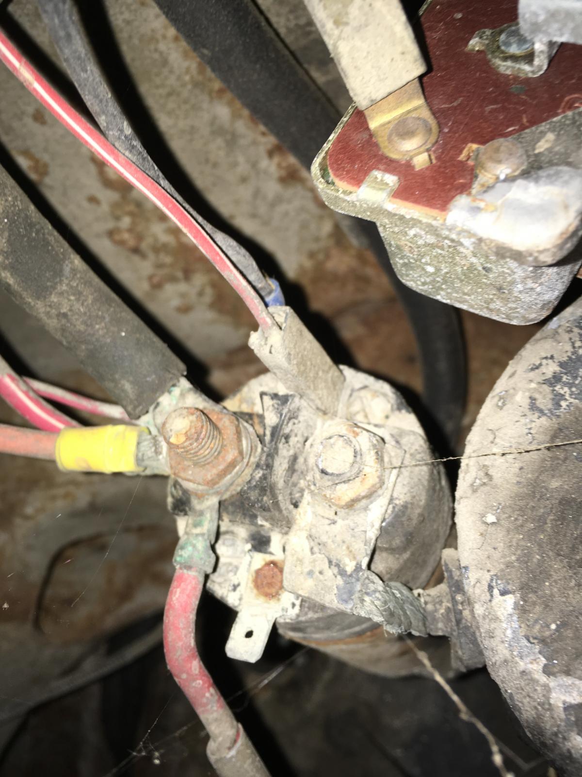

cleaned and tightened the terminals on the cables at battery end.
crawled under the bus with multi-meter. with key turned im getting steady volts at the end on the cables at the post of solenoid as well as some of the wires at the relay that is in the pic.
pic is before the engine was removed..the wires are a bit cleaner but Im about to head back out and remove and clean the connectors and check again for loose terminations etc.
more info --Before the engine removal..the starter , a few times, did make a sound harder than a click but not a big clunk...

That's the worst place to locate the relay, if you do replace it move it to the inside of the engine compartment out of the weather. To bypass it move the red/black wire from the relay to the spade terminal on the starter.
Those connections look nasty, some time spent removing and shining every connection can only improve things.

If you look inside you battery cable ends and you see a black coating that is a high impedance oxidation layer and it needs to be removed so that you have clean shiny metal showing. You can buy a tool to clean it off, or just use a sharp pen knife to scrape at it carefully. Treat your cable ends and battery posts with a goodly smear of Vasoline to prevent further corrosion.
Are you 100% sure you have the cables to the battery attached to the correct posts? Easy to get them reversed if you aren't careful. You can't depend on the color of the cable alone as VW originally used black cable for the (+) side and who knows what some PO might have put on there.

cleaned all the terminals at the starter. Cleaned up the ground to trans.
I now have power! And its cranking, but weakly. I did not clean the relay terminals. I was doing solenoid first then relay to isolate the problem--though in all fairness all those terminals are full of crud.
Some of the wires at the starter end have corrosion on the threads themselves.
Should I get some crc and squirt a bit on and then wire brush them? Or snip a bit and re-terminate?
Thanks to the usual suspects for all of the help! Ill report back later today when i can work on it again.
