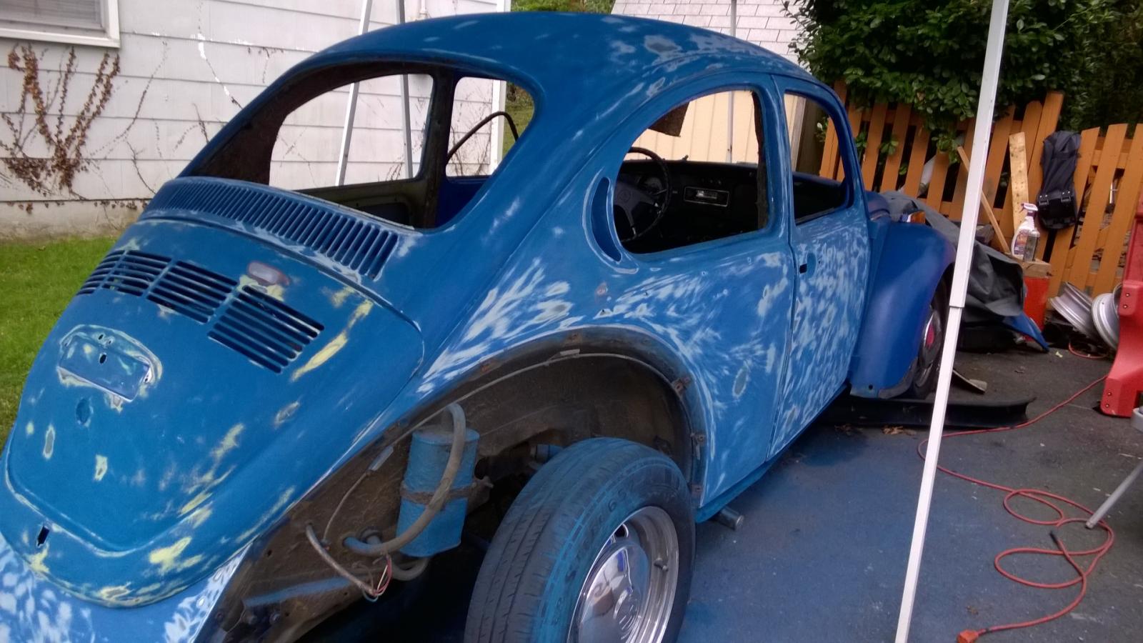

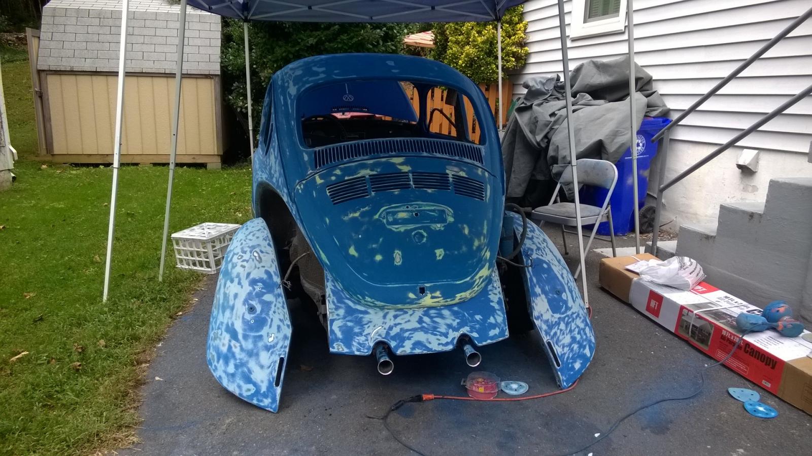

Finally broke down after a year and tore the car apart over the last week. One day to disassemble, 1.5 days so far of sanding. Still have about 1/2-day to sand before I mask it off. Then it's the HF HVLP gun and L51B Enzian Blue.
That's factory L51B and primer showing thru as I was able to sand off most of the bad respray the car had sometime in its past.
I'm looking for a good 10-footer, which is probably the best I can do in my driveway, never having painted a car before! I'll post pics when I start, probably this weekend (weather allowing).
Click to view image

PostPosted: Sat Oct 03, 2015 6:15 am    Post subject: Reply with quote
Good luck with that. I just recently did mine for the first time in my driveway as well. I too used a canopy to keep stuff off of the car. It worked great but it severely cuts down on the amount of light that gets through to the car. Definitely set up as many lights as you can, especially shining on roof area. Youll be glad you did. I have a thread in here that covers my whole trials and tribulations of my first attempt.

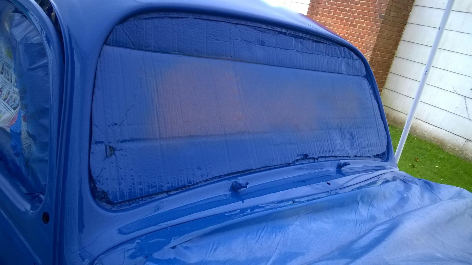

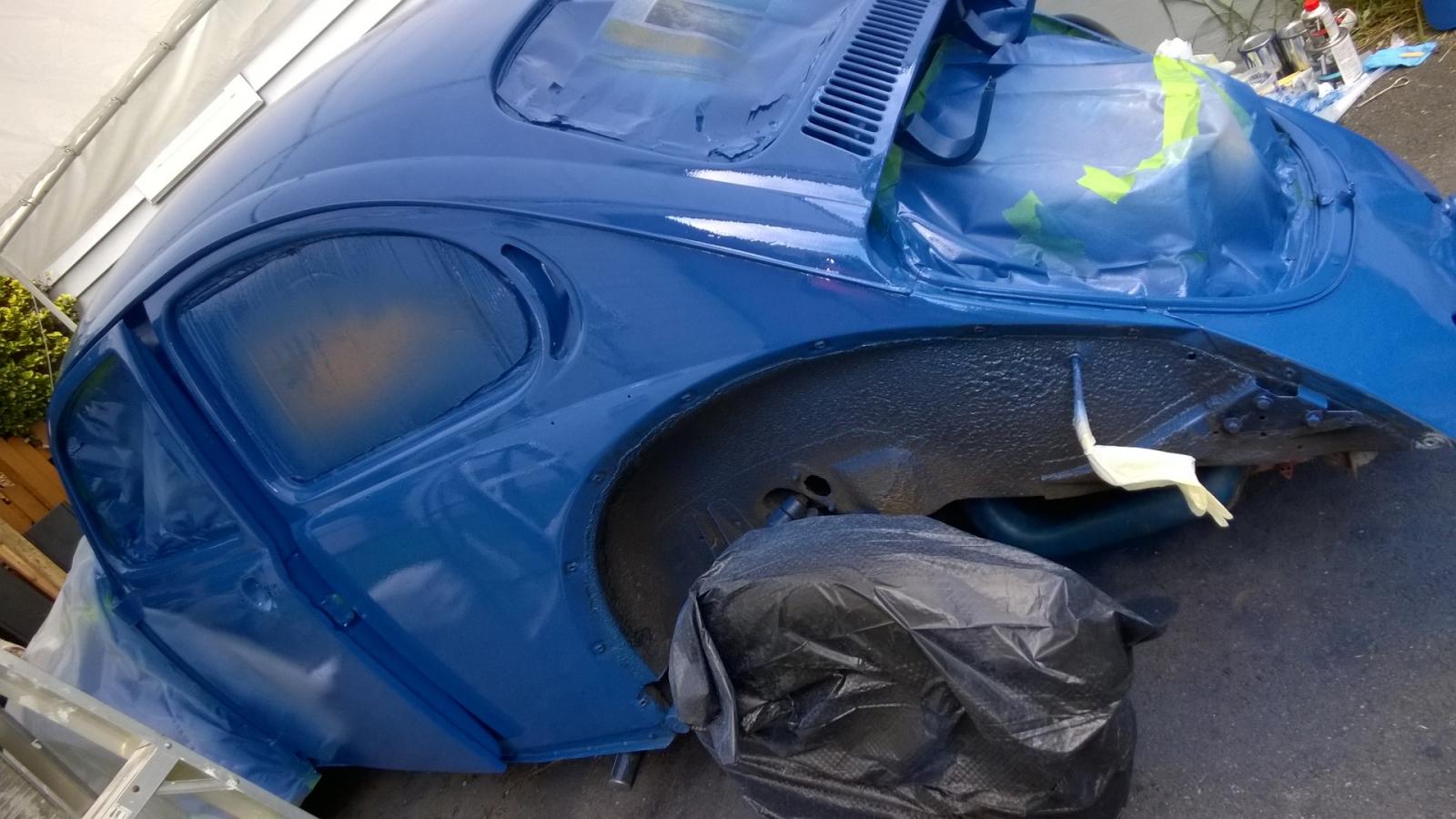

Thanks - went to town on it today.
Before...
And as of 6 p.m. tonight.
I have to say, I will NEVER AGAIN paint a car. The HF gun was fine, but this is a daily driver for me and the amount of prep is mind boggling. Never having done it before, of course there's orange peel and few runs, but it's going to look a million times better once I get it assembled...
I have to say that the HF gun was really easy to use. I'm sure if I had the luxury of time and practice runs I could make this look much better. BTW - I only did from the windshield back. I have to re-prep the hood, front fenders and quarter panels to re-do those after doing them w/rattle can type sprayers back in May. Frankly, I don't have the energy in these arthritic hands and I still have to install my new headliner. So...the front 1/3 waits for Spring.
Click to view image

PostPosted: Fri Oct 09, 2015 5:01 am    Post subject: Reply with quote
Nice! I feel the same way about the prep issue. It is absolutely mind boggling. But as Ive found out, its unavoidable. Im in the final stages of finally finishing my paint. After painting, I still had probably 3 days of wet sanding and now Im on my second day of buffing. It sems to never end.
