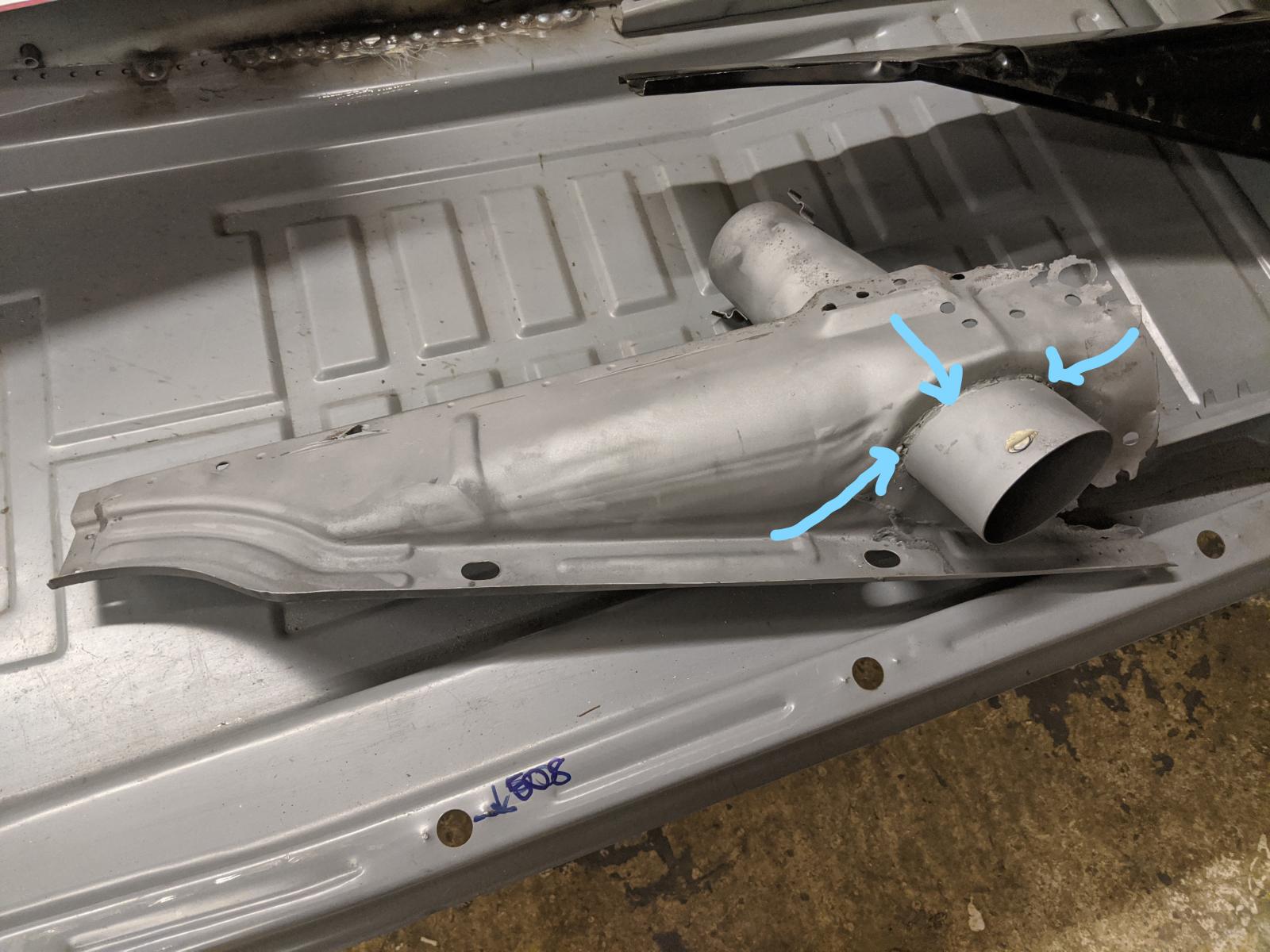

The tubes are only swaged/crimped on one side of the crossmember, at least that's the case with my '66. They are held in with a mixture of braze and bad welding and can be removed by carefully grinding around the area indicated by the blue arrows.
