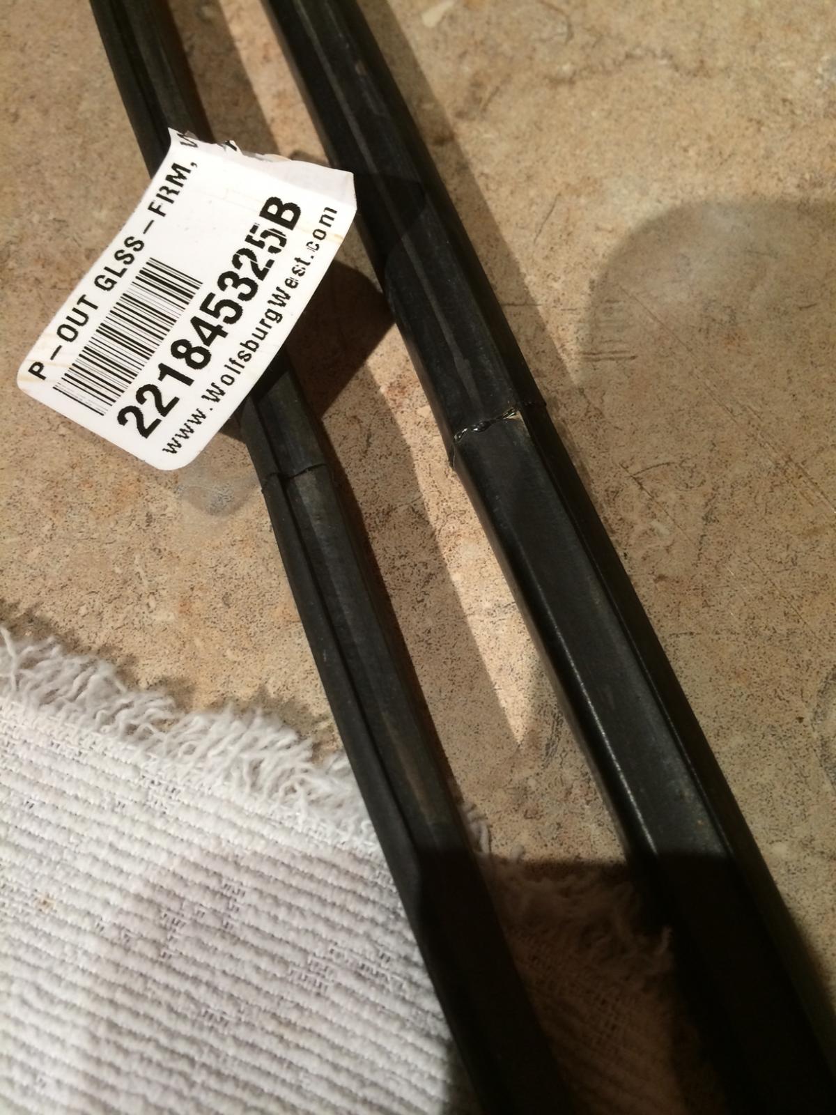

I'm redoing a couple of my Pop Out windows due to a fire, and I've had to order a new glass to frame seal. Started re-assembly tonite, and discovered the new seal is way different in size compared to the old seals I used five or six years ago. Anyone else seen this difference in size? Whats the deal.
I'm guessing that like everything else these new seals are cheaper to make, less rubber etc...They are a real bitch to get in, because now the glass is streching the seal in order to get the frames together. The older ones were a much nicer fit. Anyone have any insight on this.
In the picture below the one on the left is the newer seal, the one on the right is my older one. notice on the older one how much more seal there is on the glass surface. The newer seal does not even cover the two small casting holes in the glass.
In the picture below the new seal is on top, older one below. You can see the casting hole also.
'67 13 window dlx.

In general, repro rubber seals SUCK!
Doors, vent wings, sliders, popout, none of them fit correctly.
I'm getting really tired of slamming front doors, using two hands to latch and unlatch vent wings, and nearly breaking the popout weld tab every time I open a popout!
Oh, and as to your specific issue, I've installed popout frames and found that the glass was so tight in the seal, that it sliced right through the seal when installed.

WCM, inner poput to glass seal have always been right on the $
The WBW have been this way for quite a while, unfortunately.

I'd love to hear from some others that have bought and installed seals recently. We're just getting ready to do a set of 6 on my son's Bus and I've held off ordering seals for fear of getting some bad sets.

And that may be the difference in these two seals, I remember running into this when i first did these seals years back. One suppler was way wrong, the other was spot on. I even did an article for Hot VW's on the restoration process. I'll order one from WCM and see what I get.....I'll be happy to post the results...

Please update this thread with your findings. I have 6 new WBW seals that I just received that will be headed back to them if they are that far off.

Doing my pop outs now, but not replacing any glass to frame seals, just the ones that go on the body and the ones that go on the outside of the pop outs. Using only WW seals and they are excellent.

You're lucky. I used WW seals for this, and mine suck. They are so loose in the frame that opening and closing the pop-out can pull the seal from the grooves. I was able to put the seal in the frame by hand, and they just shake around in there...

OK...got the WW seal and yes...it's VERY small...much smaller than stock. I called them and they said they work fine. The guy I spoke to said he did a set of six a month ago, and they are a bitch to install but work and have worked for years. Anyway, just ordered one from Bustorations and one from WCM. As soon as they arrive I'll take a picture and write up a review.

Yeah, the WW ones do work, but like I mentioned, opening the windows starts to pull the seal from the frame. I don't understand the "bitch to install"... They are so small they are easy to get in the frame by hand...
I also have one from Bustoration going in when I get another latch, and the one from Bustoration is a WCM iirc...

OK...WCM called me back to tell me they are NOT in stock and don't have any idea when they will be in stock, so I cancelled the order. Got the one from Bustorations today. It was a WW one...same thing I already have. Guess I'll be installing a small one tomorrow.

I just checked the seals I recently got, and I did get WCM seals from Bustoration, but I was mistaken on which seals I got, it was the pop out body seals I got, not the frame seals. I already had those, from WW... Sorry to mislead...

So, I installed the WW seal this morning. It worked out well. It wasn't an easy job because I didn't use any clamps or jig which would have helped. To get the screws in, I was leaning against the frame with all of my weight while bearing down on the screwdriver with all of my weight to get the first few threads in. After all of that, I realized that I'd put the glass in inside out, which meant that the logo was in the wrong corner (upper left on left side window, instead of upper right), and therefore reading backward. The install was such a PITA, that I decided to leave it that way instead of redoing it! Just as I finished, the crew that was coming to cut down some trees for me showed up and a Mexican guy came jogging down toward me yelling, "KOMBI"!!! It was a nice moment.
