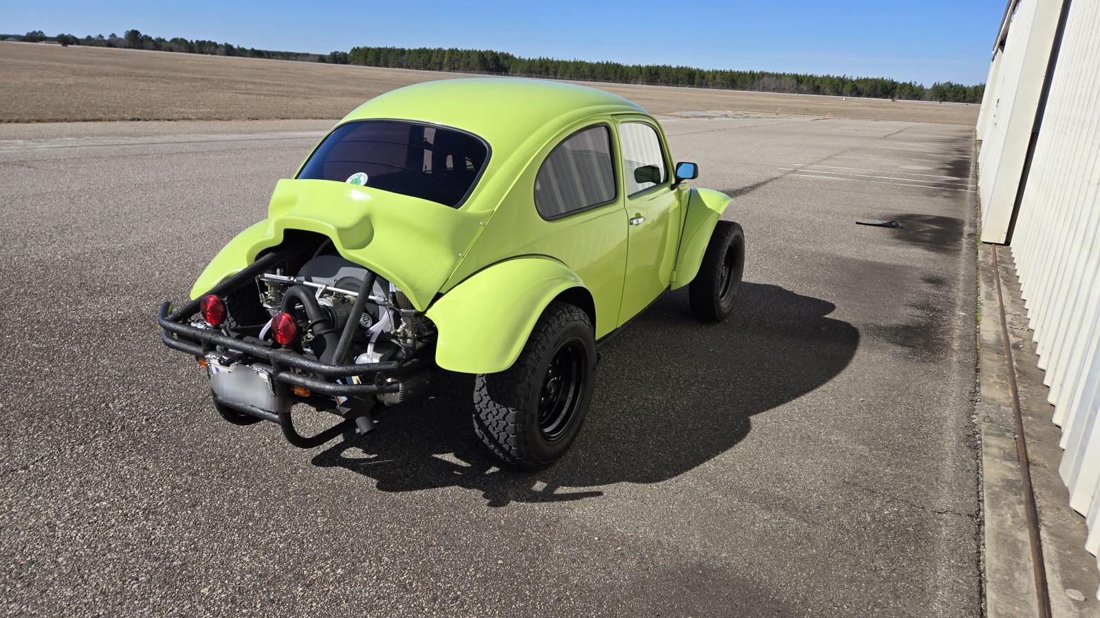

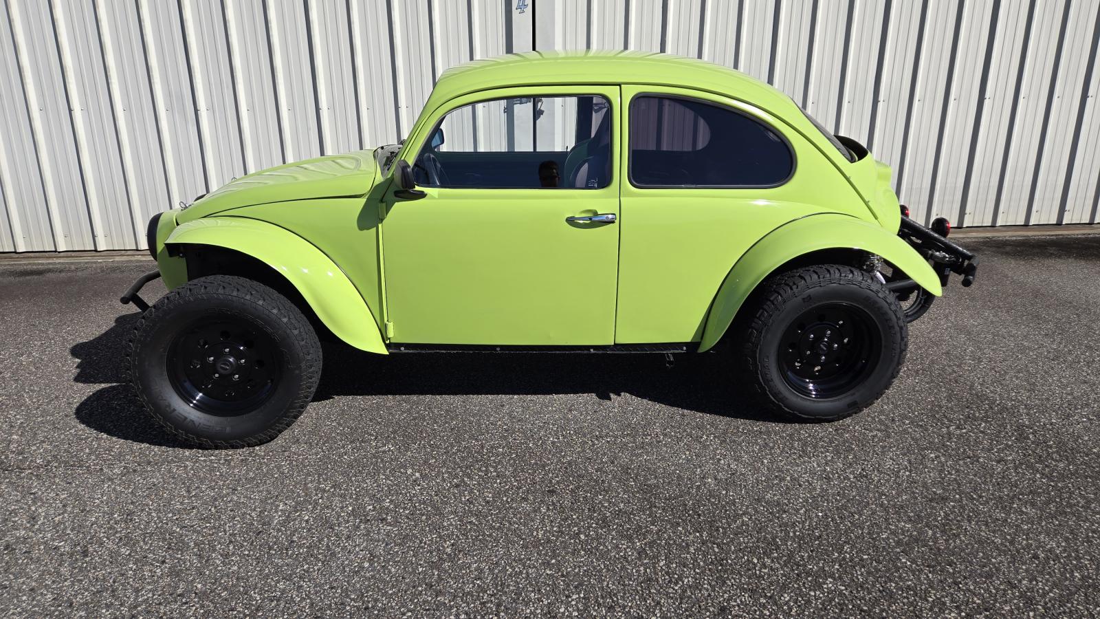

I've never owed a VW before, but have wanted a beetle for years. I really was looking for a "stock" beetle, but a near by Baja bug that just looked cool popped up on facebook marketplace and I ended up buying it. The seller has been awesome in answering all my questions since I bought it. He really did a great job on the car. From what I gather, the chassis is a late 1965/early 1966 and the body is from a 1975. This thing is super fun to drive!

The front suspension is ball joint as seen in your pics. So that makes the chassis 66 or newer. Is the rear suspension swing axle or IRS? In other words, one boot near the trans or two boots, with the 2nd one near the wheel? That can ID the chassis, some. The body is definitely not a 75. I’d say 68-70. Does it have wheel adapters? It could have started life as wide five or 4 bolt wheels. Just trying to help you narrow down the year for buying parts.
Next, maybe a close up of the engine. It looks like some kind of dual carbs. What does the previous own say about the engine specs?

VIN on the body comes back as a 75 body. I was confused because there is no dash pad, but that was removed. Parts of the old dash are still there such as the seat belt light (painted black). Chassis VIN comes back as early 1966. The previous owner rebuilt the engine. He said it is a 1641cc with basically everything new except the block. Dual weber idf carbs.

And…maybe the crescent vent behind the 1/4 window was filled. There would also maybe be the remains on the ‘75 outer seat track on the inner rocker panel/heater channel.
1966 pan makes sense. Ball joint front and swing axle rear suspensions.
