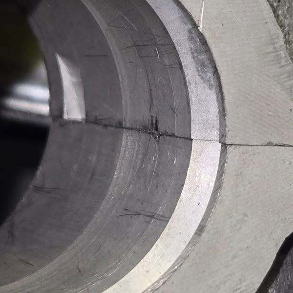

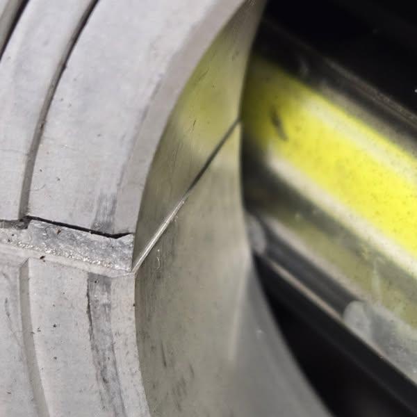

The anodized dust coming off the wear areas was so destructive in your engine hell no.
Berg has been hard anodizing their shadek oil pumps for years to bring them closer to correct outer diameter specification. You can definitely see the wear areas on the internal areas of the pump, wonder how much damage is happening due to the particulate.

What desert sasquatch was speaking of was large flakes from poor adhesion and cacking. Worn off anodizaing is microscopic and certainly not amy more or less abrasive than grit that comes through your air filter and gets in the oil.
As long as its below about 0.002" it will not cause any issues.
That being said, I wonder why they did not just mask the unner bores before anodizing.
