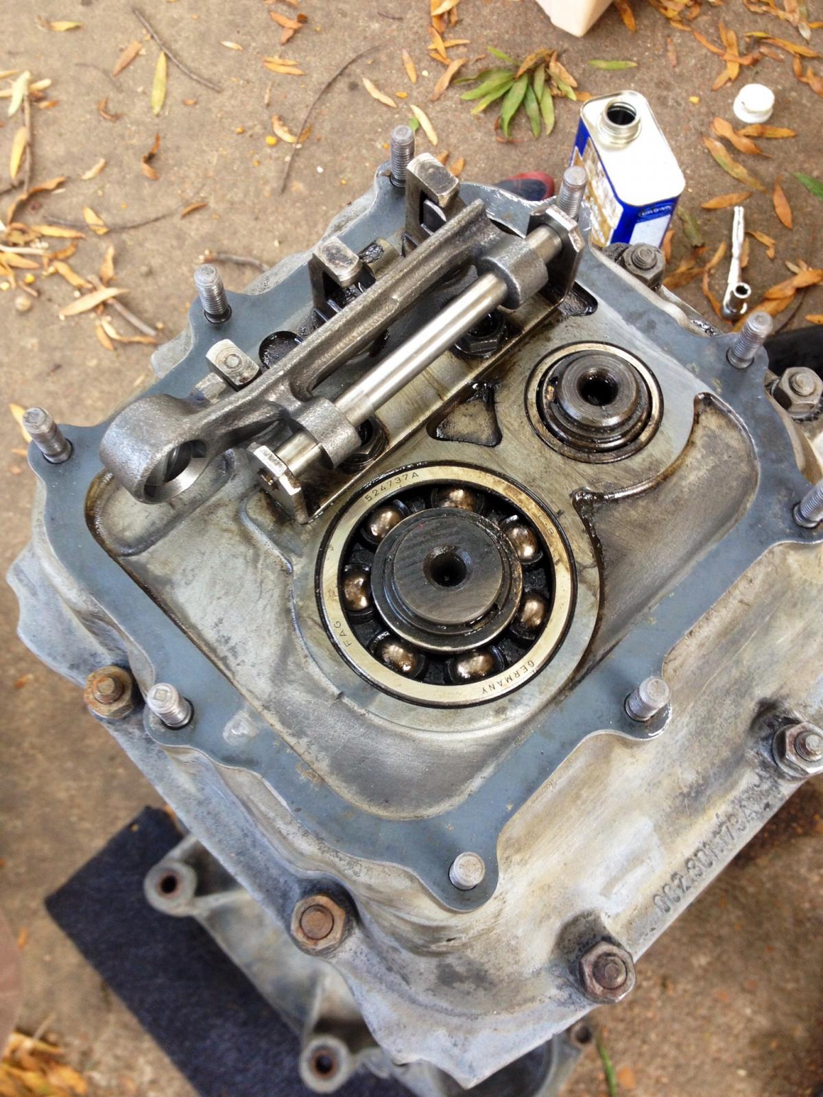

Hi everyone. Our '69 bus has been sitting for about two years. Recently we got it back up and running and initially there did not seem to be any transmission issues (except occasionally popping out of fourth as it did two years ago). But after sitting at a light in neutral and without any apparent trauma, the shifter has apparently stopped communicating with the transmission At first, it would not leave neutral, but with some messing around we were able to get it into first and home. Now, it is stuck in first and the shifter will only move forward and backward with no play to the left or right. No different feel with clutch in or out or with car on or off. We are low on tranny fluid (none at bolt level) but the gear you can feel has fluid on it. Small pool of tranny fluid has formed under tranny.
Is this a linkage problem, or a tranny problem. Any ideas will be most appreciated.

Hi, Take a look at the shift coupler and the Front shift rod bushing support.
Good Luck
Shifter Parts ID
Sometimes the shift ball brakes.
Sometimes #60 brakes.

Hi, you may have to remove a cover pan on the front. But both Shift Coupler and Front bushing can be seen and inspected from under the bus.
