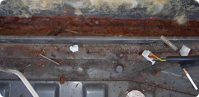

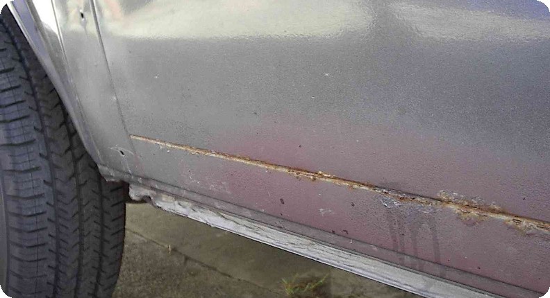

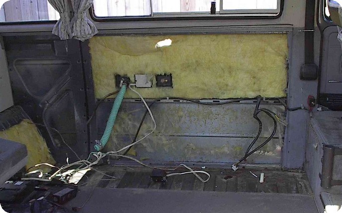

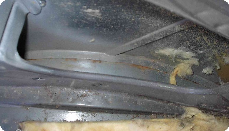

So I finally got the fridge and cabinets out and can now see the extent of the rust. I have it in a few other places, but this is the worst area by far. I hope to start wire brushing an treating the rust soon so that I can move on to other things.
I will deaden the pannels w/ RAAMMAT, but haven't chosen a replacement for the fiberglass stuff. Any ideas?
Also, I will clean and install the gowesty fridge upgrade valve. I want to replace the fan too. Should I go with the gowesty fan upgrade or is there a better alternative?
I want to clean up the propane tank and possibly paint it while it is out. Someone had mentioned that they need to be certified. Is this true? If so what does it involve? What about the regulator?

When you install your RAAMMAT, be sure that you don't install it all the way down to the floor. Leave a couple of inches exposed where the side panels meet the floor where the seams are. That way, if any moisture settles down in that area, at least it has a chance to evaporate instead of being trapped.
As far as a replacement for the fiberglass insulation, I'm not sure if your looking to improve your "R" value or a "db" value. If your looking to up the "R" value, I'm not really sure but the foil on the RAAMMAT will help keep the Bus cooler inside.

You have to make sure you get ALL the rust, that might mean welding on the side of the van there if you open up to big of holes from removing the rust.
Those rust inhibitors and converters don't penetrate very far and it will just start to rust again in short order if any rust spots are missed by you.
I'm replacing the fiberglass insulation with "NASA" insulation.
I'm happy with it so far, it's very tough stuff, also alot thinner.
http://www.thesamba.com/vw/forum/viewtopic.php?t=162330
I'm just starting in the back and working my way up, layer of b-quite ultimate and then the nasa stuff.

That is a cut out project. No way to fully remove all that rot. It came from the inside out. Find a doner V if you can,sawzall and a welder. If not any doner sheet steel and a brake for bending tight seams. Cut our the rot, sand blast any remaining rust and clean out the channel under the area of all the shit that has accumulated over the years. Do not cut into the frame, just the body rot. You could sand it, fill it up with plastic and paint it. It will look good for 4 or 5 years then the ENTIRE thing will fall off one day with the frame going with it. Frame rot =abandon ship.

You could clean it out as best you can and then coat it with POR-15. It's not a perminent solution, but it will slow the decay until you can get the time to do it right. Do it from both sides. POR-15 blocks the O2 from getting to the metal and continuing the rust process. Use it liberally and paint over it with a close color. It's not perfect, but works better than the 'liner' types of stuff.

I picked up "the must for rust".....formerly MP-7. I have used it before w/ good results. If I can't find an affordable welding option I will be cleaning things and treating aggressively from both sides. I figure I can just fill the inside area and let it soak in for a week or so and let gravity do the work.
