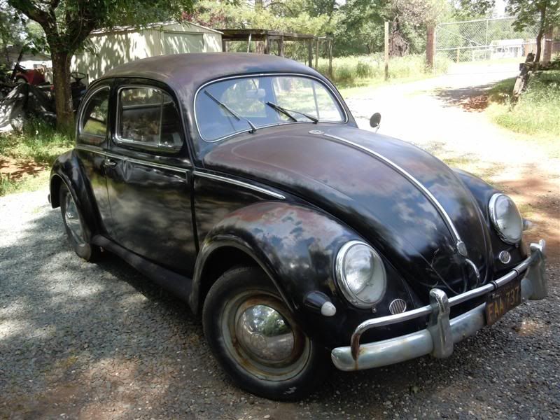

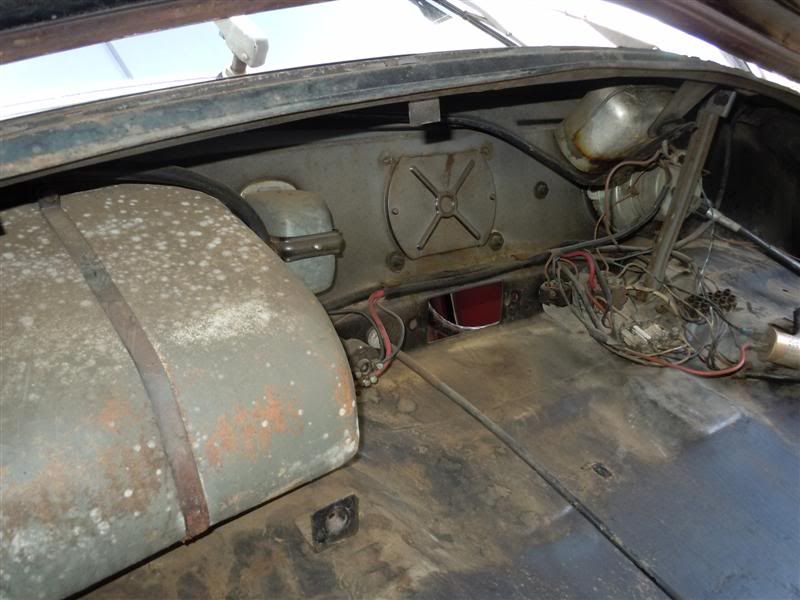

Here is a super nice almost perfect OG 57 oval that I picked up last weekend. My plan for the car is pretty simple I have already removed the complete front beam in preperation for the new 6inch KCW beam that will take its place in addition to the beam will be drop spindles also supplied by KCW the rear of the car will be brought down also with notched spring plates and new shocks. I'm replacing all the brakes components but keeping this one 4 wheel drum (stock) I will be using adapters to run the Porsche Fuchs. I have pulled the engine to completely clean it and replace anything that needs to be, before I reinstall the engine I will be replacing all the engine bay seals and fire material with all new Wolfs burg west parts. The interior is going to be easy I plan just to replace the battery tray
por 15 the floors buff out the dash and clean up the seats and call it good.
The outside of the car I'm going to do as little as possible to try to retain as much of its character as I can, so I plan to replace the running boards with some new WW I also plan to completely wet sand and buff the car to bring back as much of the shine as possible. Thats it for now I will post more as progress happens...... Also look for this car to be for sale in the classifieds soon after its finished Wink

Shocked SICK...and you know how much I love BUGS Laughing no really this is SICK I saw it in your gallery the other night... I like it !! how bad is the inside?
Wow look at that THAT'S A "SHOW CAR"!!

You're going to need 58 - 64 front brakes to go with the dropped spindles. Oval stuff won't work.
If you want to keep drum all the way around AND run Fuch's why not go hybrid link pin / balljoint? You need to get new front brakes anyway, right?

I have a black 56 with paint in almost the same condition. Are those garage shots after you wet sanded? Nice car by the way Very Happy

No those pictures of the car are ares that where slightly buffed not wet sanded.

In California they didn't have vanity plates til the late 70's, starting with the blue and yellows. But, I can tell you that since your plate starts with FAA, that it was originally registered out of Modesto California Laughing .
