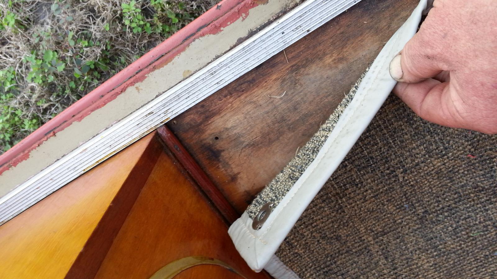

Having owned only 1 original SO-23 sisal mat, I don't have enough to go on to make this statement, so I thought I'd throw it out for feedback. It seems as though the original sisal mats were cut slightly larger, or wider, than the area between the two seat bases. The rear edge of the mat is actually where the extra width is found, so that the mat actually curls up the rear seat base, approximately 3-4 centimeters.
Is this in fact true? I'm not sure why Westfalia would have done this, but if they did in fact do this to all sisal mats, I'm sure they had their reasons.
I'm getting ready to make a template for a new sisal mat, so I'd like to get it as close to original (in size) as I can. Any input is always appreciated. |

Robert the couple original mats I have (had) are exactly as you describe.
I can prob attach a picture in nex t day or so if needed....the `60 westy is in storage at parents place. |

I have an original matt in the bus and it is bigger at each end although i think mine may have shrunk abit over the years.Any help with measurments give a call.

Posted: Tue Jul 25, 2006 5:54 am Post subject: Re: SO-23 Sisal Mat Sizing Question |
| robert davis wrote: |
The reason it's a little wider is because westfalia got the sisal in 60cm width from their supplier. That's why there's no grey edging on either side like there is on all the other edges protecting the mat from fraying. _________________ The new http://so23westfalia.com now online!

Posted: Thu Dec 05, 2013 4:01 pm Post subject: |
ok ,here ya go
the measurements of the hole are to the inside of the gromit
any other quest just ask

oh yea , i layed the mat down on the floor and asked my wife to draw a pic of it and i would tell here the measurements to fill in . somehow she drew it upside down  |
