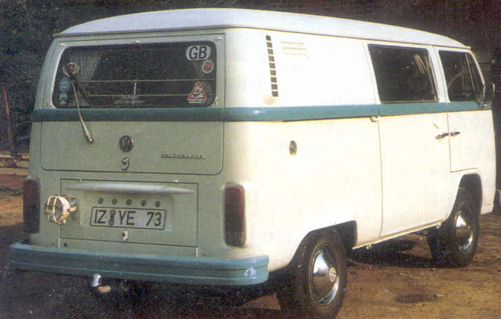

As I have hinted in the past, my 1973 VW "1600" Type 2, Westfalia Continental campervan, is equipped with a cross-over-arm, double-linkage, pantograph, rear-window wiper system, some digitally reprocessed photographs of which, I finally managed to scan, into The Samba Gallery, as follows:
Rear hatch, with cross-over, double-linkage, pantograph rear-window wiper.
The universal 12 inch wiper blade, is pivoted relative to the main wiper arm, so that the wiper blade is virtually parallel, to the bottom of the window, at the extreme right-hand & left-hand limits, of the wiper's sweep.
As one can clearly see from the pictures, this wiper system's unique design, enables it to sweep, more than half the total glass area, of this wide, shallow window. The only way to sweep a larger area, would be to fit a pair of wipers instead.
Rear-window wiper motor, crank & wiper-spindle, with home-made, custom, duralumin, installation adapter brackets.
Rear-hatch, interior trim panel, with integral, glass-reinforced plastic blister moulding, to cover the rear-wiper-motor & wiper-linkage.
My system, which I believe is compatible with the rear hatches of both the 1964~67 and 1968~79 VW Type 2s, is a relatively simple adaptation, of the stock, factory-fitted SWF system, which I salvaged from a late-1970s to mid-1980s vintage, Vauxhall Astra Mk. 1 estate car (i.e. station wagon, wagon, van, etc.), at my local car breaker's yard.
I later learned that a rear-window wiper system, of the same fundamental design, originating from a Vauxhall Chevette estate car, could also have been used instead.
Vauxhall, are the British division of the General Motors Corporation and from my research, I have discovered that estate car or van versions of the Vauxhall Chevette, have been or might have been, produced in several countries, as the Buick Opel, Chevrolet Chevette, Opel Kadett C, Daewoo Maepsy, Isuzu Gemini, Holden Gemini, Pontiac T1000 & 1000 and others.

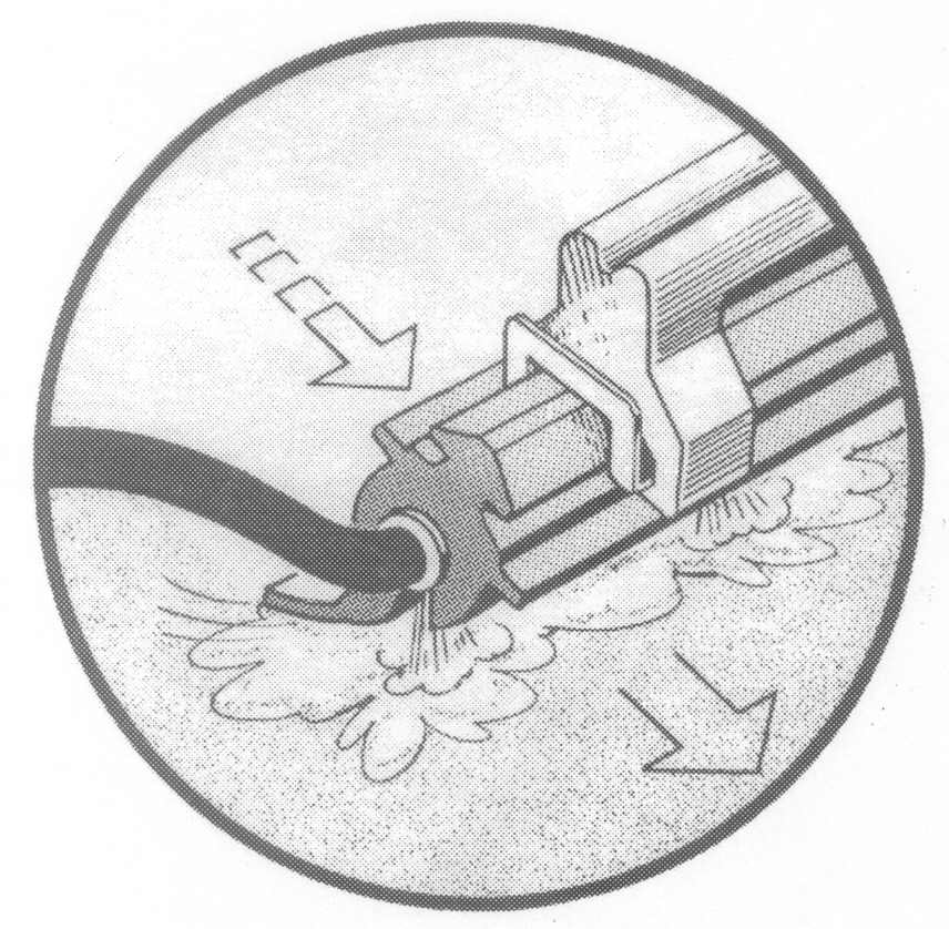

One of my earliest upgrades to the front windshield wiper & washer system, of my 1973 VW Type 2, was to retro-fit some Swedish made wash-wiper blades, about which I had learned during the mid-1980s, from some then current issues of the British magazine "Motor" and the national "Daily Mail" newspaper. The following pictures, posted in The Samba Gallery, are scans from some of that publicity material:
At that time, they were only available in Great Britain, through specialist importers, at astromomical prices, but fortunately, my university-friend in Sweden, was able to obtain them on my behalf, from his local car parts & accessory shop (ie. FLAPS in USA parlance!), at roughly the same cost, as ordinary, premium brand wiper blades. These days, one can obtain them, direct from the manufacturer in Sweden.
When I first fitted the wash-wiper blades, I removed the factory-fitted SWF washer jets from the cruciform holes in the bodywork and disconnected the associated rubber hose from the windcreen washer system. The small-bore hose for the wash-wiper blades, was then routed through the existing cruciform holes, together with blanking grommets which I had modified to conform to the holes' shape.
I have since decided to replace the SWF washer jets and drill seperate circular holes for the wash-wiper blades' supply tubing, as shown above.
The wash-wiper blades, of various lengths, are made by SW Washwiper AB, In Stocksund, Sweden. They have perforated, hollow blade rubbers, supplied by a small-bore, flexible rubber hose, which produces an even distribution of water, over the surface of the window glass, as the wiper sweeps through its arc.
One can obtain both spare perforated, hollow blade rubbers, and complete kits, comprising two wiper blades, flexible rubber hose, grommets, wiper-arm attachment adapters, etc.
See the following SW Washwiper AB website for more details:
http://hem.passagen.se/zelus
Here are some photographs, posted in The Samba Gallery, of my Swedish made, universal SWW wash/wiper blade kit, with spare wiper blade rubbers, plus a few other commonly available clips and alternative sized grommets, which enabled me to neatly install the kit, on my 1973 VW Type 2.
Having experienced the benefits of this system, which are exceedingly effective as washers, requiring very little water, I would not wish to revert to the factory-stock, body-mounted windscreen-washer jets, which were never particularly effective, wherever they were aimed and required considerable water use.
My principal critiscism of the product, is that after a few years, the blade rubbers start to split, at the place where the water-delivery tubing-adapter is inserted. A neater installation, could have been achieved, by routing the rubber tubing, along the full length of the wiper arm & blade assembly and entering the blade rubber at the far end, via a 180º bend adapter. This would also have enabled me to use these SWW wash/wiper blades, with my cross-over-arm, pantograph rear-window wiper.

This picture of David Taylor's, German registered, LHD, 1978 VW 1600 Type 2, panel-van based campervan, with full Westfalia interior, was originally featured as follows:
"David, Petra & Sarah Taylor Type 2 Campervan (1978)", Daily Drivers, VW Motoring, October 1997, page 72.
As one can see, there is a rear-window wiper of some description, but I don't know whether it's a universal accessory product or has been salvaged from some donor vehicle. Judging from the wiper's geometry, it's questionable whether it sweeps a significant area of the rear window.
Apart from my own cross-over-arm, pantograph rear-window wiper, adapted from an early-to-mid-1980s, Vauxhall Astra Mk. 1 estate car, I have only ever seen one other 1968~79 VW Type 2, equipped with any form of rear-window wiper, which was of the direct-drive type, whose wiper spindle passed through the bodywork bulge below the rear-window glass and the drive-motor was visible inside, protruding from inside the rear hatch.
Naturally, I am extremely biased, but I truly believe my rear-window wiper to be more effective and more elegant, than either of these! You judge for yourselves.
