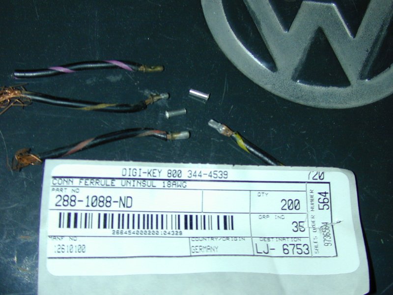

I posted this picture in the gallery here some time ago... this is what I used in the double cab.
As I said in the gallery text:
These wire connection ferrules are the closest thing I could find to match the originals VW used on their wire harness for my 59 double cab. You can see the Digi-Key part number and phone number. You solder them to the end of the wire. (They were from Germany Smile )
Note the wire on the right side was tinned and had no ferrule. Some wires have them, some don't. Inspect the old wire harness when re-wiring your car.
btw, I do collect old harnesses to scavenge wire from... who'd a thunk?
