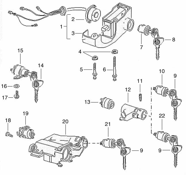

Here is a parts break down of the bolts that you will have to drill the heads off of to remove the column. Look at the bolts and you'll see the part of the bolt that shears off once it tightened to the correct torque. Hope this helps.

5 and 6 are the shear bolts. 4 must be washers, not nuts; the nuts were tack welded to the dash sheet metal.
If your steering shaft has the tabs welded on so the steering lock works, then it's worth fixing. Otherwise this setup is no more secure than the non-lockable, since you can easily hotwire it from the trunk area in both cases.
