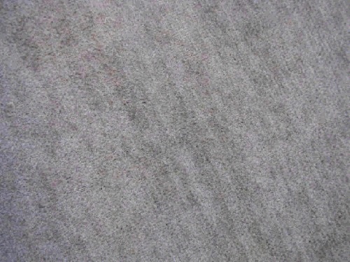

PostPosted: Thu Sep 21, 2006 2:41 pm    Post subject: Reply with quote
I went ahead and removed my OG material LR panel and I have a bunch of detailed pics I can E-mail, they are too big to post on here, I will reduce the quality and post one here in a bit but if anyone wants a good detail shot let me know your e-mail and I will send them out

PostPosted: Thu Sep 21, 2006 6:40 pm    Post subject: Reply with quote
here you go :
the material is like some sort of wool/velvet type of stuff, almost feels like the flocking on a Hazet tool kit
I can e-mail 1GB sized original photos if anyone wants them
