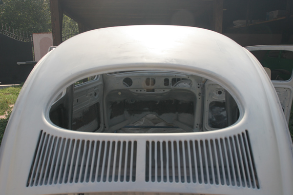

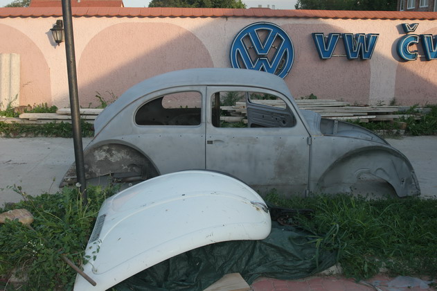

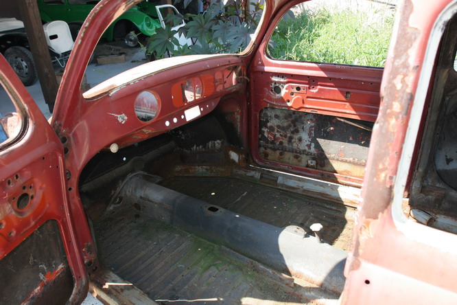

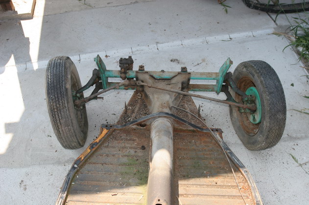

Hi guys, here are starting pictures. For the beginning I have separated body from the chassis. The pictures are randomly selected so maybe they are not following each other as they should but I will correct that in the future.
I will post more latter,

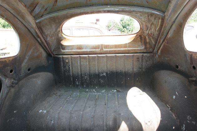

PostPosted: Wed Sep 13, 2006 5:48 am    Post subject: Reply with quote
More starting pictures!
As I move forward I ll post more
Ivan

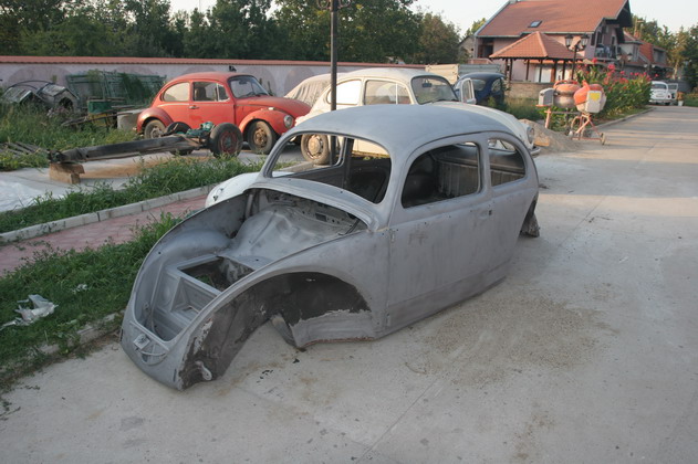

Amazing experience, sandblasting. I know and I have red all discussions about removing paint and rust with anything but the send, but for me there was no other option since only blasting here is send blasting.
I have to say that guys did a hell of the job since they worked for about two hours without brake. And at the end I had a clean bare metal body.
Now I have to primer it with epoxy primer.
see you soon.

so what is the story on the rockers? Have they been replaced? I ask because it looks as though the heater outlet is in the wrong place.

Your apron should not have exhaust cut outs.
Good luck with your project. You are off to a great start. Smile
EZ fix - boxwire and bondo... Very Happy

Shocked I agree with other comment regarding rear apron. Good luck with your resto. I have 2 '54's and one is VIN # 1-0609368 a brother or sister for sure, and the other is a bit further away at # 1-0670343, both Euro Sedans. Currently working on a '56 Rag. Look forward to seeing your pics. Thanks for sharing.

Regarding rockers, yes they have been replaced before me. I had a dilemma to cut them out or to left as it is. I decided to leave this nice and new but wrong heather channels . Maybe I can close outlets and open other at the right place as they should be.
Semaphores........, well I thought that they might be buried and now after blasting i can see that something is welded inside. Maybe Ill dig to check.
Rear Apron. I didn’t know that apron should not have exhaust cut outs. But now when you pointed out I have looked pictures and saw that some have and some have not. Another dilemma! Question

To be correct for '54 it should have semaphores, and no exhaust cut outs.
It just depends on how far you want to go. You will ask yourself this question many, many times during this project. Wink

I am terrified! Shocked Last night my friend worked on my beetle till late evening. Had to fix some minor body flows, patching and fixing. It was planned to be finished by today and in a day or two it had to go for the paint job. And than my worst fears came to reality. Suddenly it started to rain from bright sky, light at first. I had no time to take the body inside and was not much worried so just covered the body with standard beetle cover. As time went by, light rain has just become heavy rain and at the end severe storm. Although my beetle is decently epoxy primered I am trembling from fear. Any experiences Question Is it going to affect my project. It still rains. Crying or Very sad

Epoxy primer should protect your car from the rain just fine. Don't make a habit out of leaving it in the rain in primer but one storm shouldn't hurt it in any way. If it was regular primer (not epoxy) I would then worry because that stuff is like a sponge and it suck it all the moisture you could throw at it.

Leaving that car exposed like that will not harm it if you leave it indoors! One night out side and the morning dew will make it turn brown AKA surface rust!
Good luck on your project and be ready for a bunch of obstacles you will encounter on your way!

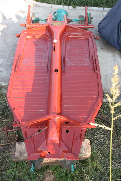

PostPosted: Mon Sep 25, 2006 7:26 am    Post subject: Reply with quote
Few new pictures as I move forward. The pan has been grinded to bare metal and than epoxy primered.
Ivan

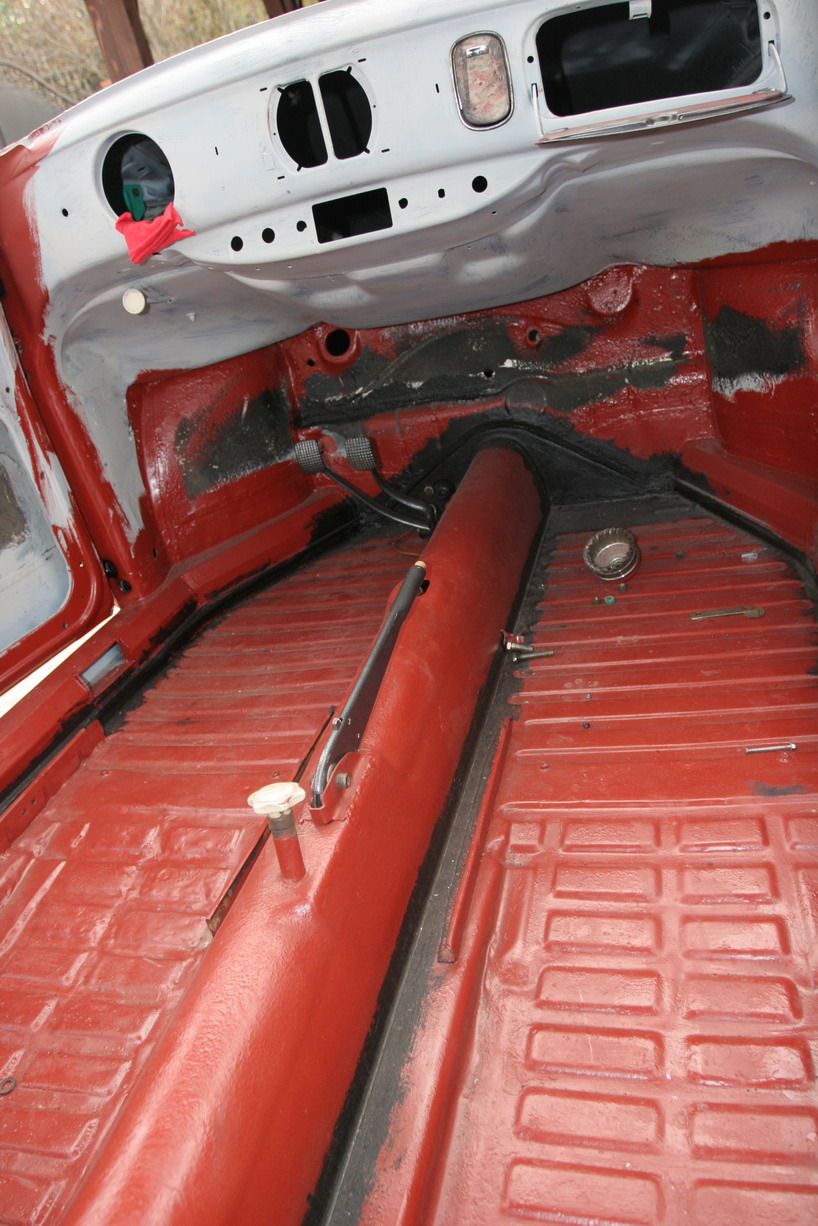

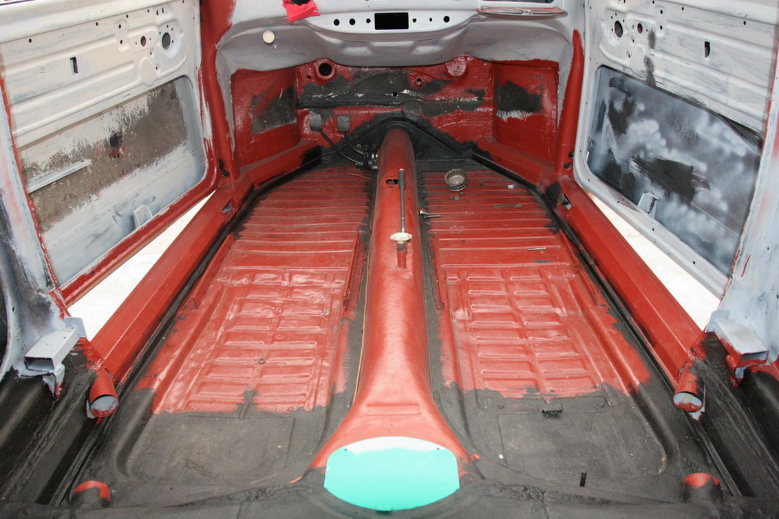

PostPosted: Mon Nov 06, 2006 2:31 am    Post subject: Reply with quote
Well guys (and girls, if any) I was busy working on my project in order to finish with painting before winter. I was a little lazy for posting but here now here are newest pictures from my restoration.
Please continue to comment and advise all you think.

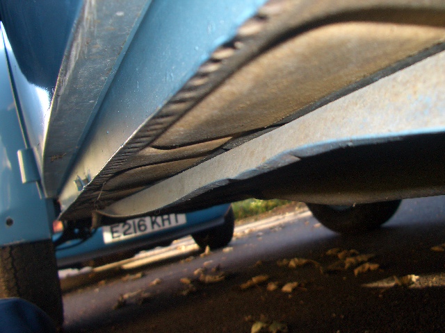

PostPosted: Mon Nov 06, 2006 7:05 am    Post subject: Reply with quote
how it should look in that last pic,
other than the bends in the floor made by the f##king shippers when they took my 54 off of the container.......

You need to weld those taillight holes closed. You can drill new mounting holes after the car is painted. And I agree with the others about eliminating the exhaust cutouts and opening the semaphore boxes if this is indeed a '54. (And cut the lawn!)
