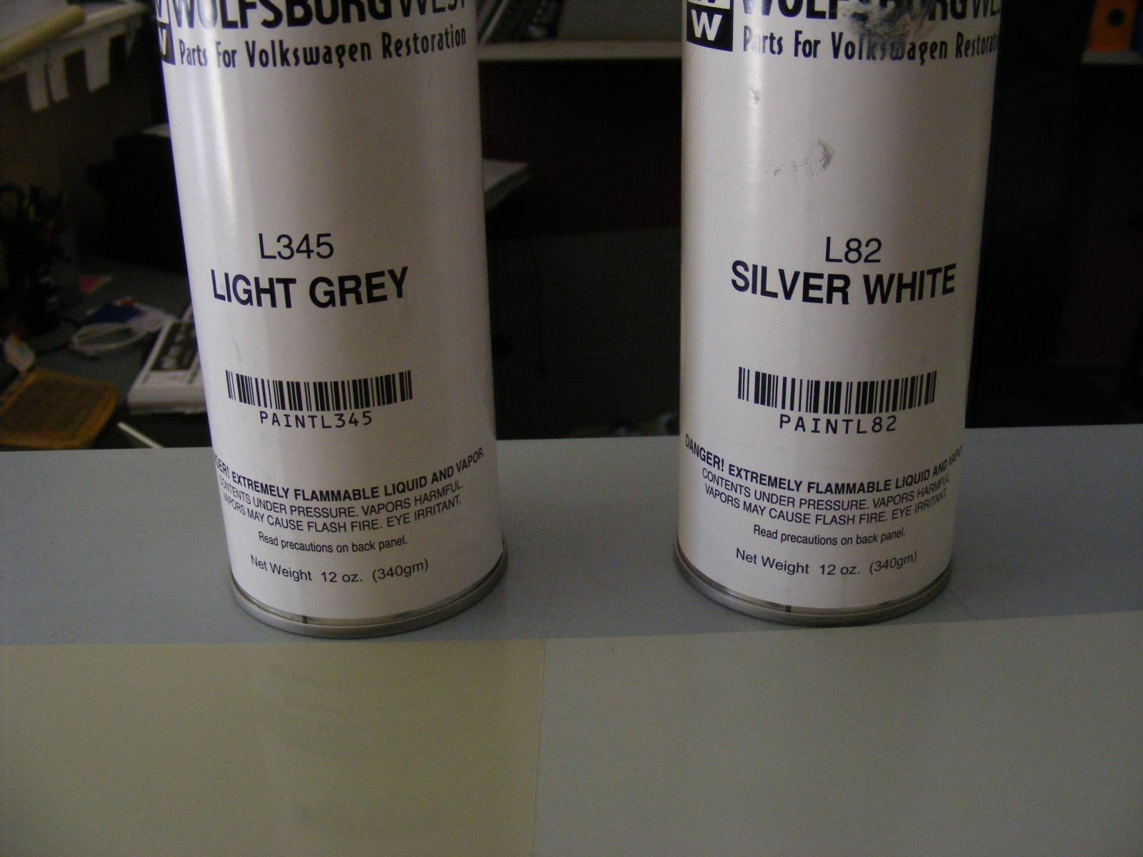

We are currently restoring a 63 Twin Cab for a Client here in Australia. The TC was TKD and painted Gulf Blue, using BALM paints code 1/3/503. I need to be able to paint the Rims and Hub caps in the right colours. I cannot find any samples here in Oz that can be trusted. I obtained Pressure packs from WWest but when sprayed out they are not what I expected. can anybody help with a sample big enough for me to use a Spectometer (sp) so that I can get the colours mixed here?

fwiw, I have a of paint light grey 62 and the WW west spray can is nowhere close to matching. It’s much more dark and richer than the original paint.

Hey Lind- If you are offering up L345 samples, please add me to the list. I am happy to compensate you for your time and effort. I can vouch that the L345 rattle can "match" that WW sells is far from perfect.
