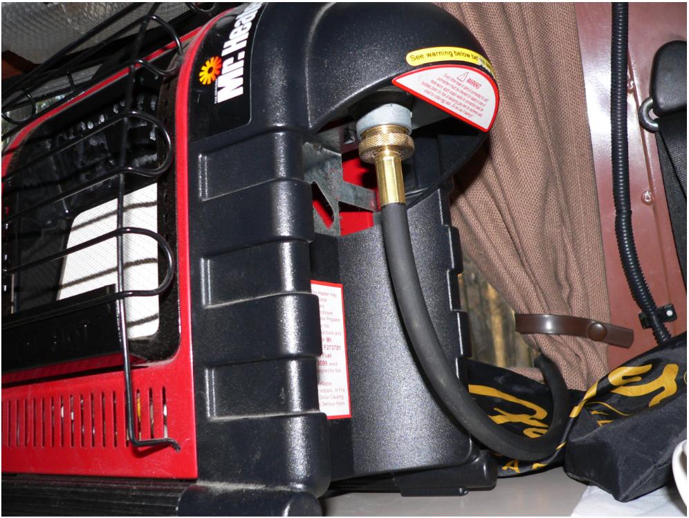

I have used the Mr. buddy, the big one with the fan built in. It worked great. This was north florida winter though, not snowing or anything, pretty cold though! we just stuck it on the front table.
I'm sure you clould plumb in an adaptor hose but I think it comsumes a fair amout of propane. So if you are using your tank for fridge etc.. you might come up short on long weekends etc.. I have a spare westy tank that I am considering putting in on the otehr side of the bus with a connection hose only, that I could use for the heater and gas grill etc.. just so I don't have to carry extra cylinders etc.. I have just been kinda lazy to to get to work on that plus a buddy from the "Full moon bus club" that I always camp with always has clyinders at the ready as he has one of those refill attachments for the protable cylinders at home. we just give him our empties.

The one pound cylinders always seem to run out about 4 AM and changing them in the cold, dark, cramped Westy was a treat.
I'm planning on plumbing in a quick disconnect for it in the Westy's propane lines, then putting in an "extend a stay" hook-up on the outside.
