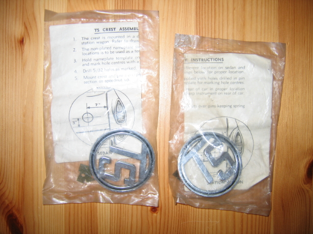

Badge and original instructions:

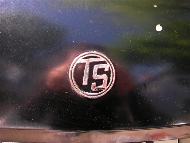

Vehicle examples:

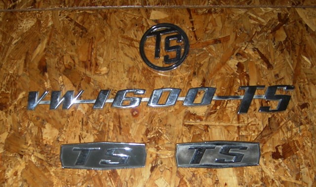

I have been thinking about this a while and if the the the TS was just a Canadian marketing tool and not a factory or VW trademark then who made the VW1600TS scripts for the 66-69 Notch and Fastback? Like the one in the middle. Was the TL emblem also For marketing or just what was used in other countries besides the U.S. Don't they both have a VW 311 part numbers?
found image from in Berts pictures.
I don't know on that VW_1600_TS emblem but it looks like a real VW emblem.
The TL is the Fastback model name in Europe so that badge is 100% real.
