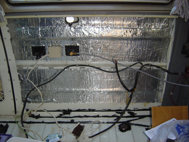

Just thought i'd share my experience with my recent interior project since I had mentioned it in other posts. This is on my 87 Westy. It all started when I decided to add a laminate floor, I removed the fridge to paint the grill at the bottom of the door and just check things out when I saw some rust behind. I decided to pull the interior to see how bad it was. This is what I had, not too bad, but I felt it needed to be delt with:

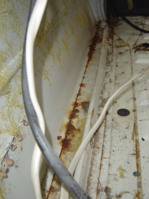

I wired brushed it all and then treated it with Por-15. I then put "Frost-king" duct insulation on the bulkhead.

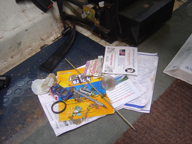

Heres all the stuff I found under the benchseat when I removed it:
Not sure it was the best choice, but for regular insulation I went with R-30 house insulation that was encased in plastic for "no-itch" I left a small gap between the floor and insulation.

Floor looks really good, Kevin. I noticed that you also changed out the house 110 v outlet cover plate to grey---I did the the same--nice touch.
Its amazing how many people have rust below the water/electric inlets behind the stove. I live in CA and I took my interior out for the first time this year and I had rust and standing water back there! The gaskets for the inlets are worthless so be sure to silicone those boys back in there. I removed both my water inlet hookups (never used the city hookup in 10 years) because I noticed that my water tank fill inlet also leaked at the hose union. I always fill the tank from the inside anyway so I can see how full the tank is. I may move my electrical hookup underneath the van behind the driver's seat so I can seal up all three holes in the side of the van and never have to worry about rust lurking behind my cabinets. I wish I had some plastic blanks that I could just pop into the inlet holes and seal up forever.
I used a double layer of silver bubble insulation to keep any moisture from building up and a base layer of Foilastic on the metal itself to dampen vibbration and also provide a radiant barrier.

Nice job on the rust removal! "Rust never sleeps", you have to deal with it, and you have.
No matter how nice the floor looks (and it does look great), getting the rust under control and eliminating it's causes are what have added value to your van.

It looks like you put some sound deadener on
did you remove the original spray on glue? or can you just stick it on top of the glue
I'm in the middle of doing the same kitchen rust removal and I'm worried that if I just apply the sound sheets that they may fall off at some point and I don't feel like ever doing this again.

That whole project took me 2 weekends, about 4 days of work 30 hours or so if I had to take a guess. I don't have a new picture but I moved the gauges from where they are in the picture to on top of the instrument cluster. I drilled a 1/2" hole, installed a gromet and ran the wires through. I left the wires long enough and installed quick disconnect connectors so that if I have to remove the cover to get at the instrument cluster or master cylinder etc I can set the cover aside on the dash without disconnecting the gagues. I like the location, it's right on top of the tach which houses the temp gauge so it makes for an easy quick scan. I recommend the laminate floor also to anyone, beats the hell out of the carpet!
To answer the question about the glue: I did not remove it. I used the "Frost-King" peel and stick type insulation and you can tell when you stick it on it ain't going anywhere anytime soon.

Found under your seat;
Vintage Hot Wheels Corvette in rare cerulian blue circa 1971. One of only 7 made. At auction, now valued at more than van.
Youv'e also got 26¢, and a nice roach leftover from a Dead concert.

I did find part of a roach under the seat but I figured that an oz of weed came standard from the factory back in 87'....
