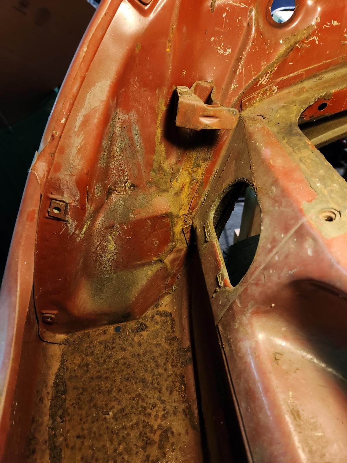

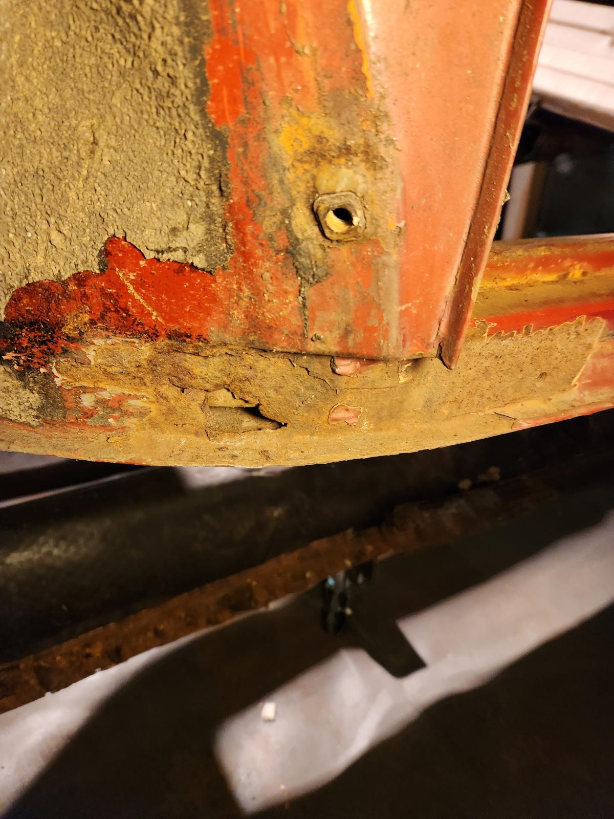

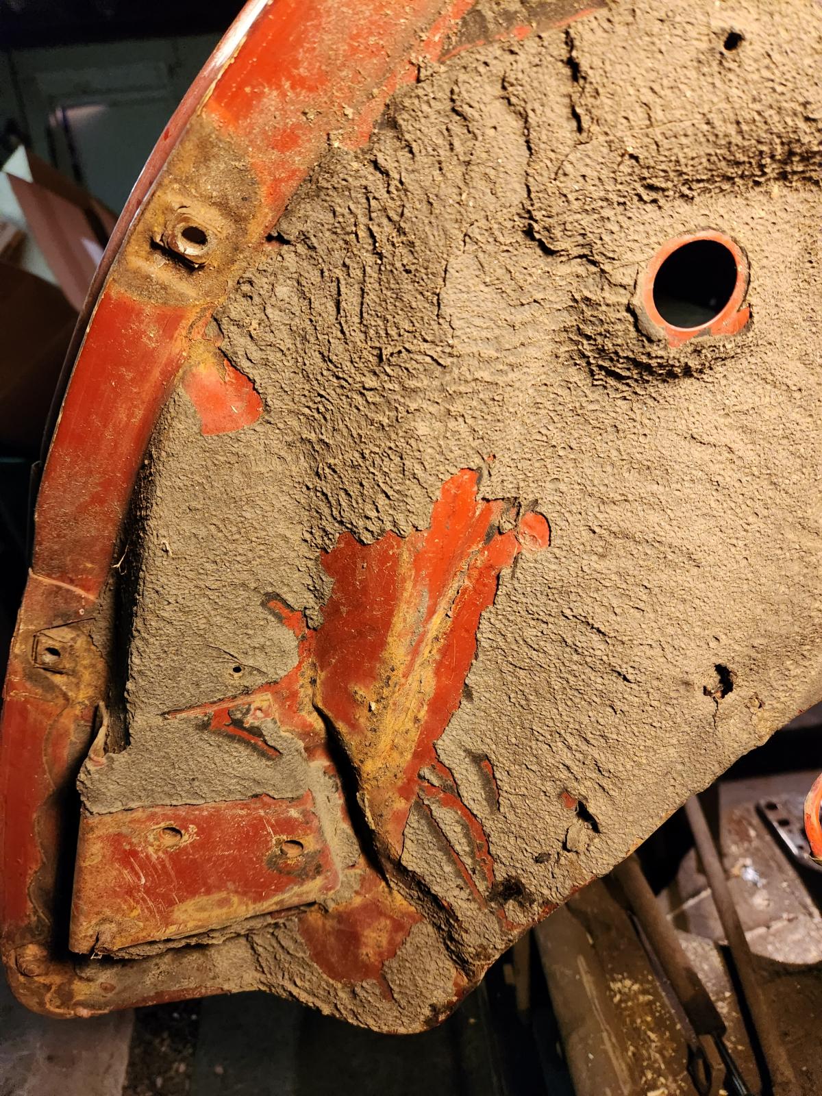

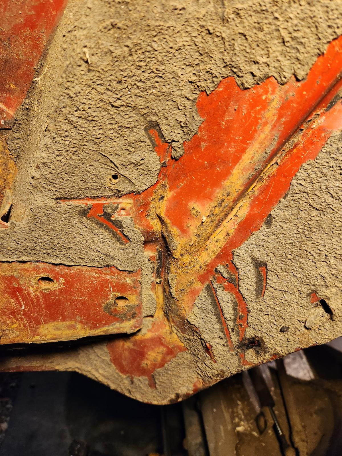

PostPosted: Mon Jan 16, 2023 11:56 am    Post subject: Front End Repair or Replace? Reply with quote
I am doing a restomod on a 69 Beetle. There is damage from a front end collision that has been somewhat repaired but there is quite a few wrinkles left. I also have a front clip that is in good shape from a donor car. I'm hoping to get some feed back about weather I should try to further repair the original or weld in the donor clip. What do you think? Pictures below of the current damage.

PostPosted: Mon Jan 16, 2023 2:53 pm    Post subject: Re: Front End Repair or Replace? Reply with quote
If it was me I would make a bumper mount that has a hook on the end of it so you could take a come-a-long and pull it out. It would take some time to get it where you need it but I do not believe it is crunched that bad.

PostPosted: Mon Jan 16, 2023 5:14 pm    Post subject: Re: Front End Repair or Replace? Reply with quote
I'd try repairing it. As mentioned I'd try pulling it. Get some tension into the panel, and then work the hammer and dolly on the wrinkles.

PostPosted: Tue Jan 17, 2023 10:36 am    Post subject: Re: Front End Repair or Replace? Reply with quote
Thanks for the advice! I think an old nerf bar would probably work to hook the come-along to but I will have to wait until the body is back on the pan try that. I am not trying to build a show car and I think pulling it back out will be easier. I did a lot of welding in the early to mid 90's but I'm sure I'm going to have to relearn those skills once I get into the bodywork. There are some bends in those areas from the factory and I think the biggest issue will be figuring out how to reform them properly. Thanks again!

PostPosted: Tue Jan 17, 2023 1:38 pm    Post subject: Re: Front End Repair or Replace? Reply with quote
Bolt the fenders & bumper on it.
Only heat/hammer & dolly anything underneath that messes up the fit/gaps.
Wrinkles underneath don't need straightening usually.

PostPosted: Wed Jan 18, 2023 3:39 pm    Post subject: Re: Front End Repair or Replace? Reply with quote
Depends on what you plan on doing with the car. It could be repaired, but I'd bet it tears a bit when pulling.
