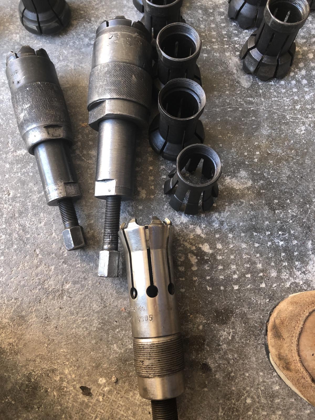

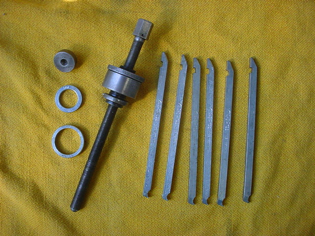

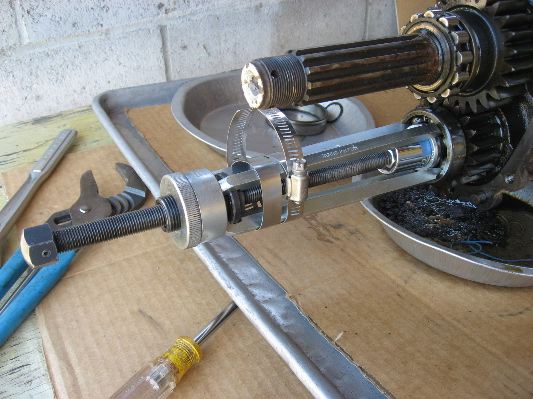

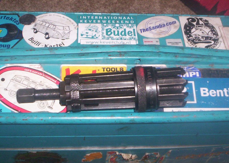

There are a few different puller types I own and have seen. See pics below. All are essential specialty tools, designed to properly pull bearings off shafts, which is really what you are doing, when it all boils down to it. The procedure is not some ultra mysterious "VW only" operation.
"Baum Type"
"Kukko Type"

Kukko series 70 also is useable on a wide variety of bearings.
http://tools.baumtools.com/kukko2.jsp and then go to "Bearing Pulling and Extracting tools" to open a pdf file that shows series 70 type pullers. I have a Belzer version of this puller, and while it takes a little finess to set it up, it works excellently, and I have different rings for both type bearings found in reduction boxes. I believe the Kukko number for the proper puller is the 70-2 type.
I looked a little closer at my Belzer/Kukko puller. The arms are Kukko 772, and the Belzer housing is number 4582N.
