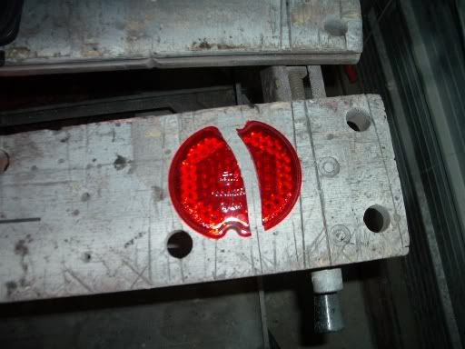

Hey I'm going to list some tail light lenses in the classifieds. I know nothing about buses and don't want to list them for too much and look like a knucklehead or list them for too little and rip myself off. I searched the classifieds and could only find plastic ones to compare to. Any idea of what these sell for? This are made of glass and say Hella SRBL17 on them. any info is appreciated, Thanks.

Rob,
I'm offering $75 each for original German lenses like this. I need 2 for my 23-window. If that's a good offer for you, let me know. If not, let me know anyway.

happyhippo wrote:
Rob,
Thanks!
Jeff
your 23 window would take K3235 lenses which are hard to find.
$75 each is a very good offer on those lenses.
those lenses are SRBL17 lenses which are correct for '59-'61ish.
I have been trying to research these lenses, but it is very difficult due to the design flaw of dollar taillights in general and they way that they love to crack lenses, so even very original cars can easily have replacement lenses in them.

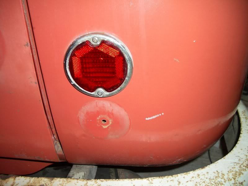

Robbo wrote:
Very easy to break the glass ones:
Just a little over exhuberance with the screwdriver and........KKCCCKKK! Rolling Eyes
Oh damn. I guess the next time I mess with my tail lights I will be sure not to go crazy. I still have the original glass lenses in mine.

My '58 came with one cracked and I managed to crack the other one. Sad How good do the plastic ones look:
http://www.wolfsburgwest.com/cart/DetailsList.cfm?ID=211945241AX
Can you spot them from 10 feet?

One thing that people tend to overlook when snugging up the bezels on the lenses is that the bezels tend to warp - concave in towards the bolt holes. If you gently bend the bezel back against it's concavity (Is that a word?) so that the bolt hole section of the bezel is the LAST part to contact the lens rather than the first part, you will get a better seal and less chance of cracking the lens.
Also, as Lind has opined, if you ground the tail lights "manually" with a wire and hose clamp around the bucket, you will not have to rely on the barb to ground the bucket to the body. If the bucket is already grounded, you can be gentler on the torque of the tail light bezel screws and further protect the lenses.

Also If you have them too loose the vibrate and crack. Had this happen to me. Some plastic ones are poor and some are great looking (from England). Also Joe G repoped glass ones. I didn't like the look of them.
