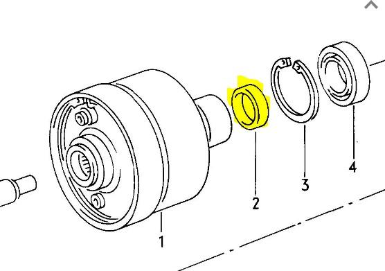

Does anyone knows where I can source the spacer that goes behind the Viscous Coupling? Or has the precise dimensions so I can make one? Highlighted in the image below.
https://shufti.files.wordpress.com/2011/10/img_4905.jpg?w=620&h=465
Part number: 094-409-456
Does the Solid Shaft sold by Van Cafe needs this spacer?
I guess it's purpose is to prevent the VC from sliding on the splines, does anyone runs without?
Thanks!

Inside 35,10mm
Outside 42,10mm
Wide 9,45mm

Rock 'n Nun!!! Danke!!
