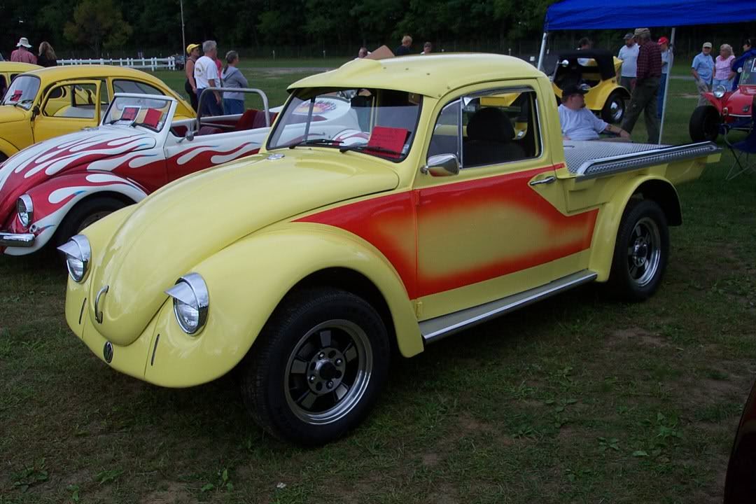

Sorry, i couldn't find anything either. I found a small site a coule years ago that had the buildup of one and some info but I couldn't find it just now. I probably have an article about them in one of my old VW magazines but I just put them back in storage.
Here's a couple pics I found here.
