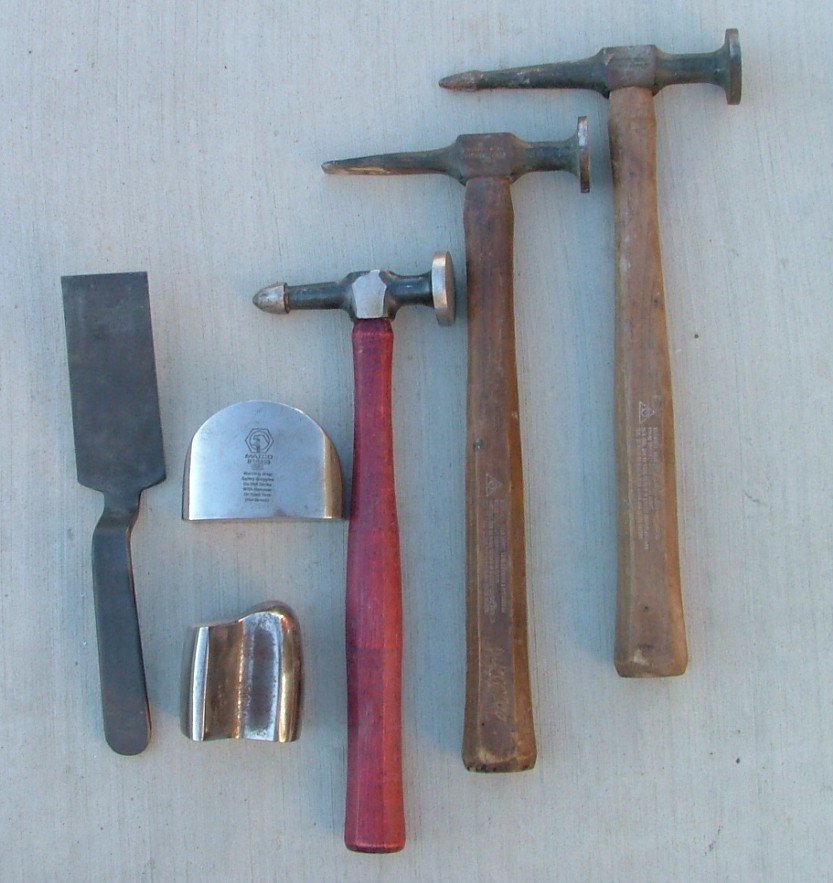

Ok so lets talk about some body tools.There are in fact many many tools for this type of work. Hammers, Dollies, Slapping Spoons, Shrinking tools Etc. But we are going to make it simple and go with the basics.
Here are some basic body tools that you should have. From L-R, Slapping Spoon: good for slapping dents, adjusting gaps on doors, fenders, prying corners of doors and fenders ETC. Dollies: Half round(TOP) and Heel dollie(Bottom), these are used as a way to disperse the blow from the hammer, usually held in one hand on either side of the panel while hammering. I also use Dollies to shape curves in metal and knock out dings they are good for alot of different tasks. Lastly, Hammers: there are all types of hammers, peck, blunt, edge....some are small, large, short or long, wood or fiberglass handles. I have a huge assortment but i will pull out some basic tools to show how they work.On the hammers that i will be using, one end has a semi flat head while the other has a point or a flat edge on it.
You can buy a starter kit that contains these items from such places as Harbor Freight or Eastwood and starter kit is fairly inexpensive. _________________ This is my 23rd year in the Auto Body/Paint Game!

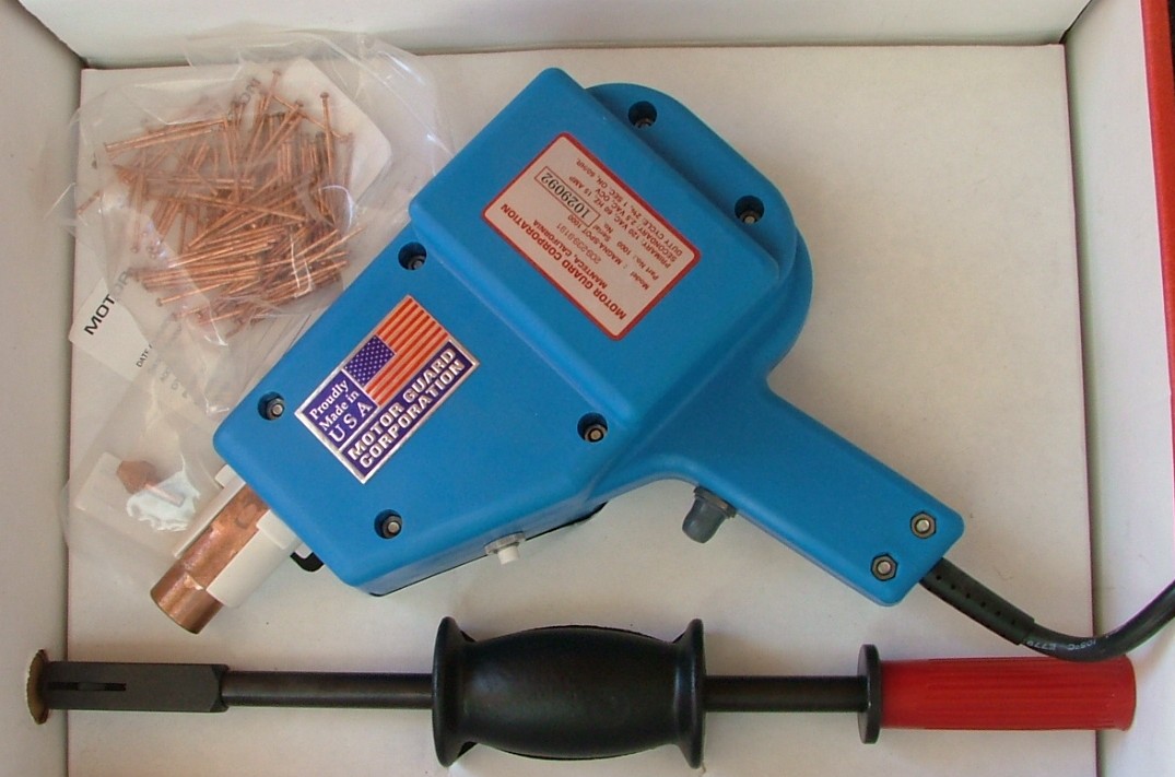

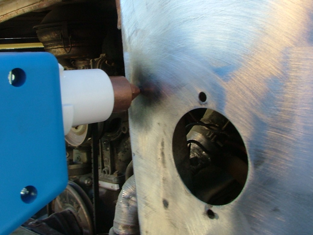

The BodyMans best friend....The Uni-Spotter or "Nail Gun".....this is an awesome tool here is how it works.
Here is a dent that has a support brace behind it so i cannot get to the back of it. Now the dent must be down to bare metal. I load a copper nail into the gun, place the nail in the center of the dent, push the machine down to make contact, pull the trigger and count one-one thousand and release trigger and it has welded the copper stud to the metal.
Next i attach the puller to the nail and pull on the puller to remove the dent.When i get the dent out i gently tap the surrounding area of the dent to reset the metal. Then i remove the puller and remove the nail by twisting it off with pliers. If the dent is deep or it is a crease it may need multiple nails............... This machine takes a little time to get used to but it is a great time saver and will help tremendously in repairs....This starter kit goes for around $200 _________________ This is my 23rd year in the Auto Body/Paint Game!

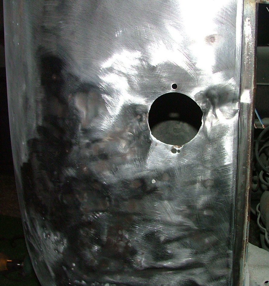

Ok so now moving over to the left quarter, this side had the obvious cracks especially around the tailight hole. So once i stripped the paint and filler off you see what i have to deal with.....The filler was over 1-1/2" thick in areas and the filler was applied directly over paint........this is very bad.......filler should be placed on bare metal with the bare minimum of 80 grit scratches in the metal for adheasion purposes.
So i am starting with the tailight hole as i do not like filler around any type of hole like this because it will lead to cracks.

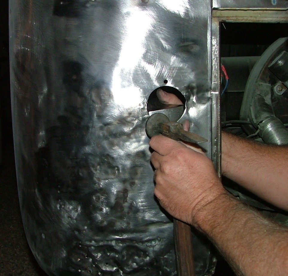

I start with my dollie on the outside and i slowly tap the metal outward with my hammer using the wide face of the hammer. I am using the dollie as support for the metal because i do not want to "Stretch" the metal by just banging away, i use the dollie to help deaden the blow from the hammer.
Dont just get the hammer in there and brute force it, take your time, you will see how little force it takes to get the metal to move. Patience is critical here as this will be your "Foundation" and you want to take your time and work it to get the metal back into shape.
I just continue tapping the dent back twords the dollie and use the dollie to help flatten the metal, i am trying to get the majority of the dent out by using this method. The better you get the metal to come back straight again the less filler you will need to fix the little imperfections. _________________ This is my 23rd year in the Auto Body/Paint Game!

As you can see we will need the "Nail Gun" to finish off the area on the other side of the tailight hole as a brace runs through that area. _________________ This is my 23rd year in the Auto Body/Paint Game!

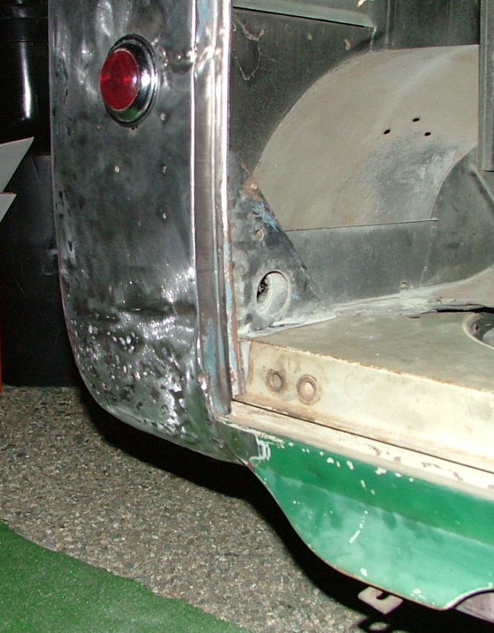

Ok this is bad, this is the lower part of the left quarter panel where it meets the rocker. This is a lazy mans rust repair, never do this, filler does not make rust go away..........it makes it worse. I am replacing the rocker anyway so i will slice this out and replace it...............you just never know what you will find. Over the years i have seen some very creative ways to fix rusty metal, from screen door and tin foil to drywall tape and stucco screen........sometimes i really wonder about these people that fix cars like this.............More to come. _________________ This is my 23rd year in the Auto Body/Paint Game!
