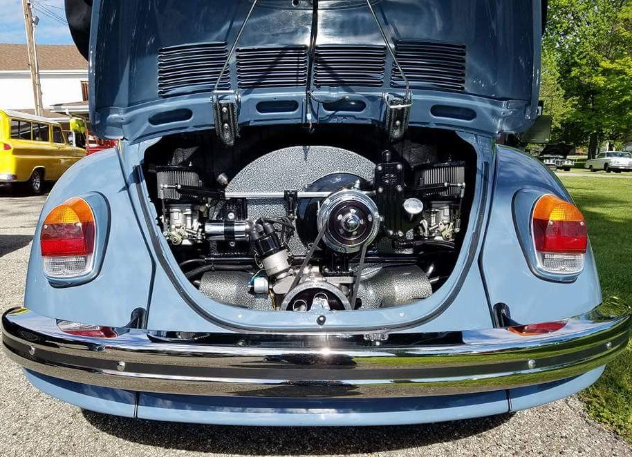

It took me the better part of six months to get this 69 convertible nice. It needed so much work but the fit and finish is really nice. Notice how the bottom of the fenders fit the rear apron. Those are the details that most people miss. Even the underside of the decklid was color sanded and buffed.
