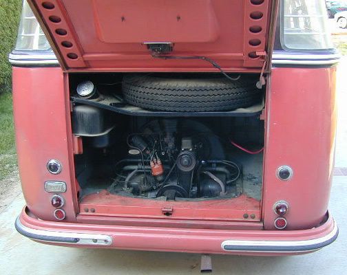

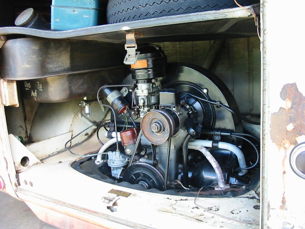

Good work Deano. Things are going fast for the '54. Here's a pic of the engine bay in my '54 216. The whole chassis, cargo interior, and the inside the deck lid are gray. Most of the gas tanks are a "different" color gray ... one with more blue in it. It can get confusing. If I can get organized, I'll get some "lipping" pics of the panel, for you. For the primer gray, I use a proper urethane single stage with flattening agent. Works well. NO roof lining ... The entire cab area, including the cab divider, are painted the body color.

Hey Rick, your engine compartment looks sharp. I like to see it "primered" like original. Too often you see the ENTIRE engine compartment painted the body color when it originally wasn't, even on deluxes.
A couple questions on your engine. Shouldn't the generator nut be painted and shouldn't the coil strap have a slotted hole in it?

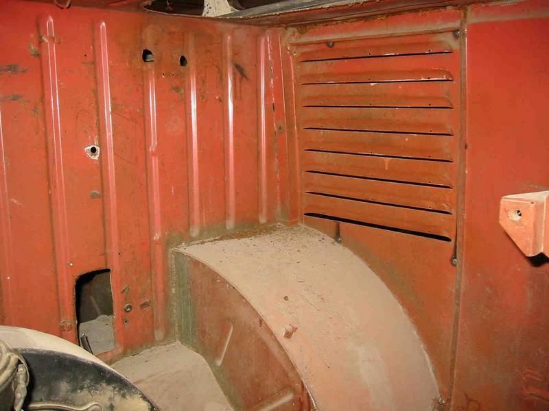

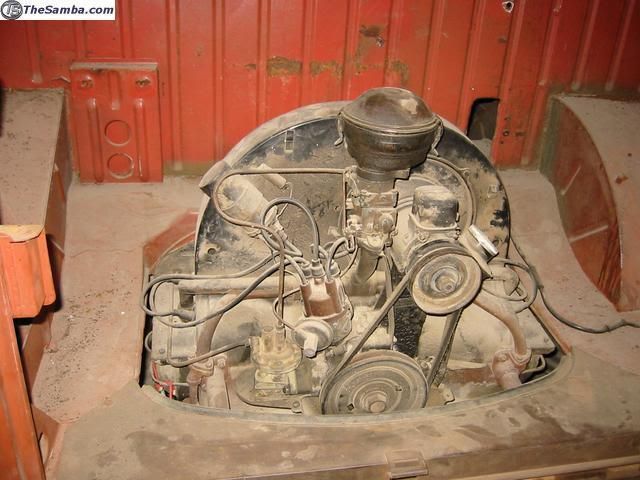

Just so I can post too... my truck is in the original primer:

Dedication to the cause... The transmission is out right now too. Anyone need some good frame photos?
There are various detail shots here:
http://www.thesamba.com/vw/scrapbook/54truck/details.php

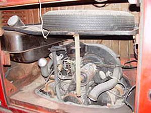

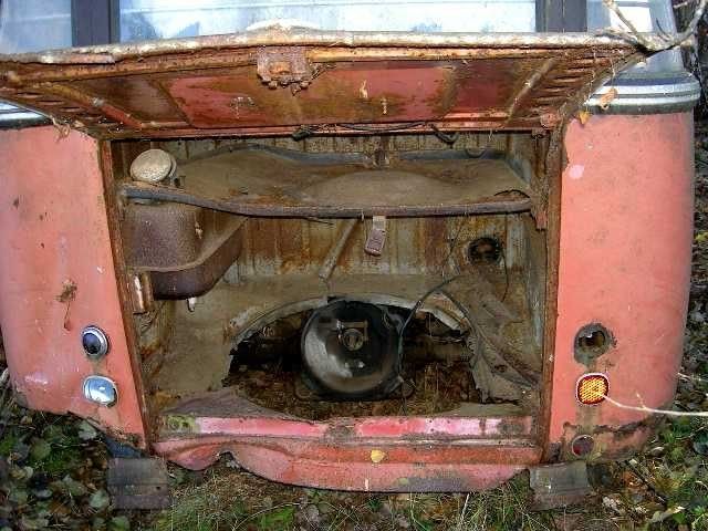

heres some examples, all og paint (at least in the engine bay) i believe. compare 'em
the ex bret 53 dlx
wisks 54. pretty untouched is my bet
anchovy's 54
my feb 55
