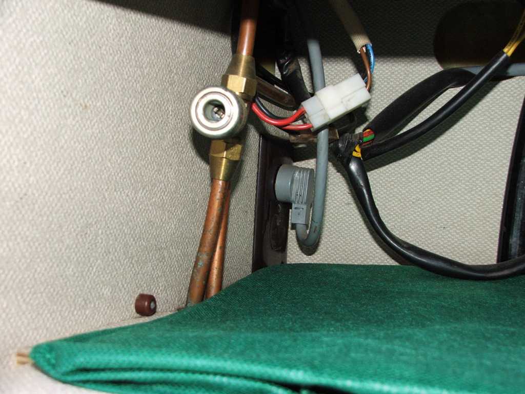

Amishman has what looks like an inlet connection to his stove propane line underneath the sink cabinet from a PO.
Why not do something like that, and add a 5# tank in the cabinet? _________________ No need to bear the weight of your worries, you let them all fall away...

mightyart Samba Member
Joined: March 24, 2004 Posts: 6188 Location: Portland, Oregon
| Back to top |
