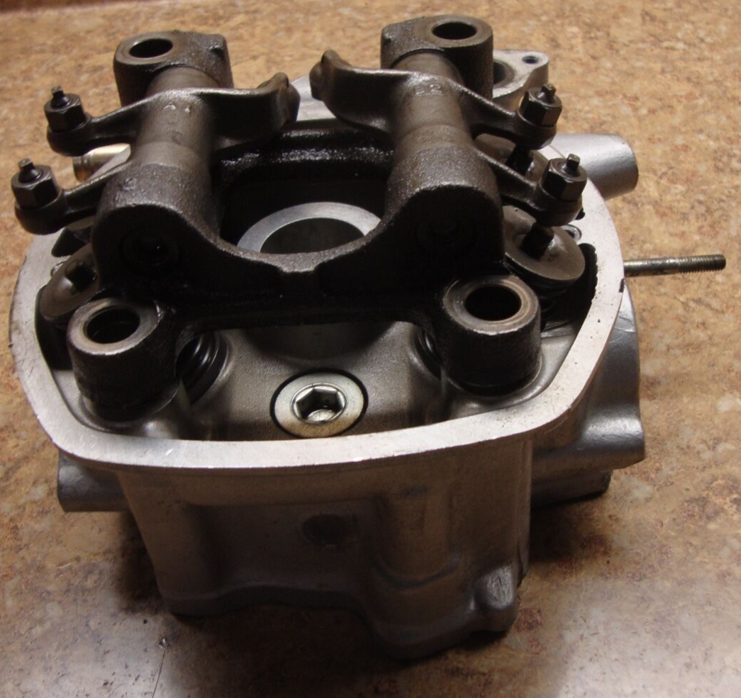

Surely the canted valving adds something, even if it’s just means potentially bigger valves.
I think the ARAO heads (with one rocker pressing against another rocker) to get 4 valves per chamber has the same issue that Cummins 24 valve heads have, which use a bridge across 2 valves being pushed down by 1 rocker. In that the system doesn’t support any cantering of the valves, as they have to be parallel to each other. Forked rockers allow the inlets & outlets to canter towards each other. Meaning greater potential in a number of ways
Gez is there a way of shrinking images during the posting process, or does one have to do that in a image editor before uploading, ie manually?

That looks like the old Honda cx500 water cooled motorcycle. I did not know it was a forked design.

[quote="Dan Ruddock"]
Can you imagine if someone used that design as a basis for some rad VW heads. Just flipped upside down & doubled up & with the inlets coming in at right angles to where it comes in in the pic. Only problem it would mean a total redesign of the pushrod setup & probably the lifters & cam. Ideally a complete kit would be the go, with roller rockers with roller tips, hydraulic roller lifters & custom roller cam plus redesigned pushrod & tube layout.
I always fill that with just one or 2 cylinders per bank, a multivalve OHV setup (ie with pushrods & rockers) would be more ideal than OHCs. Of course with 3 or more cylinders per bank OHCs become the obvious choice.
