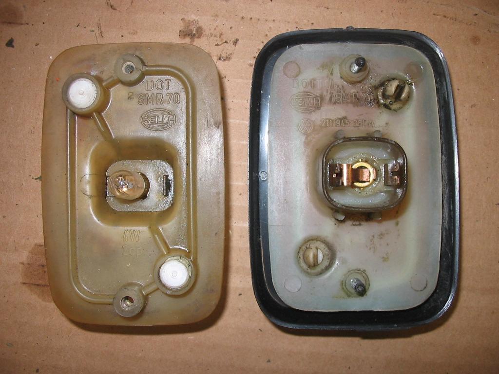

Here's a nice Christmas project I just completed. I first read about this a year or two ago on Daniel Stern's website, and always wanted to do it:
http://www.danielsternlighting.com/tech/markerflash/markerflash.html
I didn't realize then that on our busses, the front side markers were just reflectors. So this Christmas, I finally decided to do something about it.

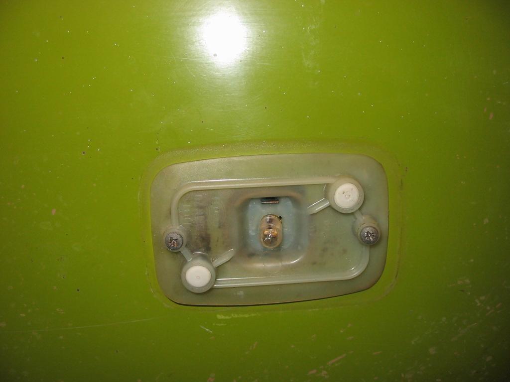

Get two used rear side marker socket inserts. The hardest part of the project is drilling the hole in the front door to accomodate the socket insert. I used a template, but since it's all covered up by the reflector anyway, neatness isn't too critical - just make sure you use the rubber gaskets. I also put shiny foil tape on the plastic socket holder to increase brightness and relectivity. Then just wire the two wires from the sidemarker to the turn signal and park lamp wires that pass right near the headlight. It doesn't matter which wire goes where. I was wiring my Bosch H4 headlamp "city lights" at the same time (from this thread: http://www.thesamba.com/vw/forum/viewtopic.php?p=1675856&highlight=#1675856), so I did them all at once.
I'm really happy with the results. It all works exactly as it says in the Daniel Stern link above, and it looked really cool in my darkened garage. The side markers flash in sync with the front turn signal with the lights off. With the lights on, they alternate, which looks cool. Of course, with the headlights on or park lights on, the sidemarkers are lit up. With just the hazard lights on, they all flash in sync.
I'm going to do this mod to the rear sidemarker lights, too, and turn them into turn signals. It will only involve switching one wire (the ground wire from ground to the turn signal feed).

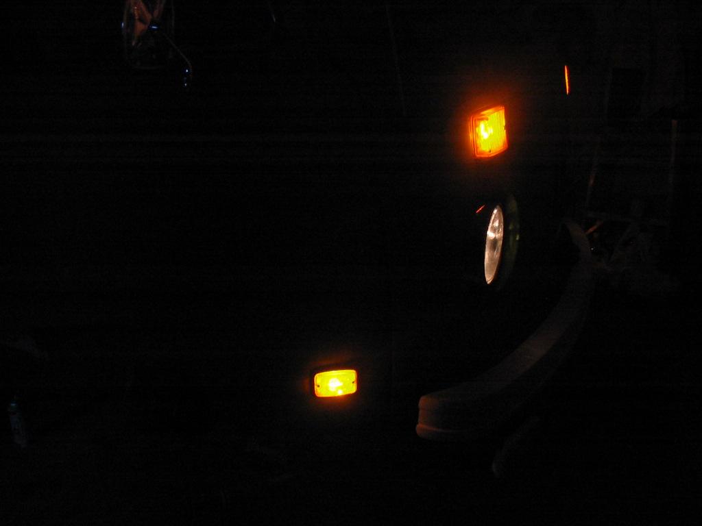

And here are the results. The dim headlights are my "city lights".
Darryl

cool idea!
make sure you treat that bare metal with something! if not you will end up with rust! even if it's just touch up paint!
PUT SOMETHING ON IT...
Nice idea though, and makes you safer at night!

The front turn-signal lamps of British and European specification, 1968~79 VW Type 2s, contains only one, single-filament, 21W bulb, unlike the North American specification, 1968~79 VW Type 2s; having a single two-filament 21/5W bulb on 1968~72 models or a two-filament 21/5W bulb and single-filament 4W or 5W bulb on 1973~79 models.
The two-filament 21/5W bulb, corresponds to the 21W turn signal & 5W parking light, whilst the single-filament 4W or 5W bulb, corresponds to the front side-marker light, found on 1973~79 models
The single-filament, 21W bulb, of British and European specification, 1968~79 VW Type 2s, corresponds to the turn signal, whilst the parking-light facility, is provided by a single-filament 4W or 5W bulb, mounted in the headlamp unit.
In many European countries, daytime use of dipped headlamps or daytime running lights, are obligatory and subject to serious fines in some cases. This is likely to be introduced into the United Kingdom and other European Union countries, in the "interests" of EU harmonisation of lighting regulations.
Hence I might update my British specification, 1973 VW Type 2 Westfalia Continental campervan, by retro-fitting 1968~72 VW Type 2 front turn signals above the bumper and replace the British & European specifation, high-level, 1973~79 VW Type 2 turn-signal units, with those of North American specification, with clear quartz-halogen bulbs, amber bulbs and aftermarket clear lenses, to provide daytime running lights, parking lights and turn-signal side repeaters.
The British and European specification, 1968~79 VW Type 2s, were never factory-fitted with front or rear side-marker reflectors or lights. During the late-1970s, I had for reasons of improved safety, already retro-fitted North American specification, front side-marker reflectors (cab-door mounted) & rear side-marker lights, the front ones of which, I shall upgrade to side-marker lights. I also have some OEM, 1968~79 VW Type 2 pattern, Hella turn-signal side repeaters, which fit onto the B-pillar, rearward of the cab door.

dansvans wrote:
but havent you ever used a hole saw? if you cant get the exact right size, a sanding drum on a drill would finish up the sizing real good.
I was trying to get a snug fit with the recessed socket, but ended up going back and forth with filing the edges with a small hand file, and then the screw holes wouldn't align, so I just took my jigsaw and cut it larger. Since its all covered up, and the hole is protected by the rubber gasket that surrounds the socket plate, I wasn't too worried.
If I was doing it again, I would probably just cut a nice round hole like is done for the rear sidemarker lights.

nothing to worry about- just that hole saws are so fast. i suppose the rear holes would make a good template. thanks for the idea. keeps idiot drivers from getting the idea they have an excuse to slip by me as I change lanes.
