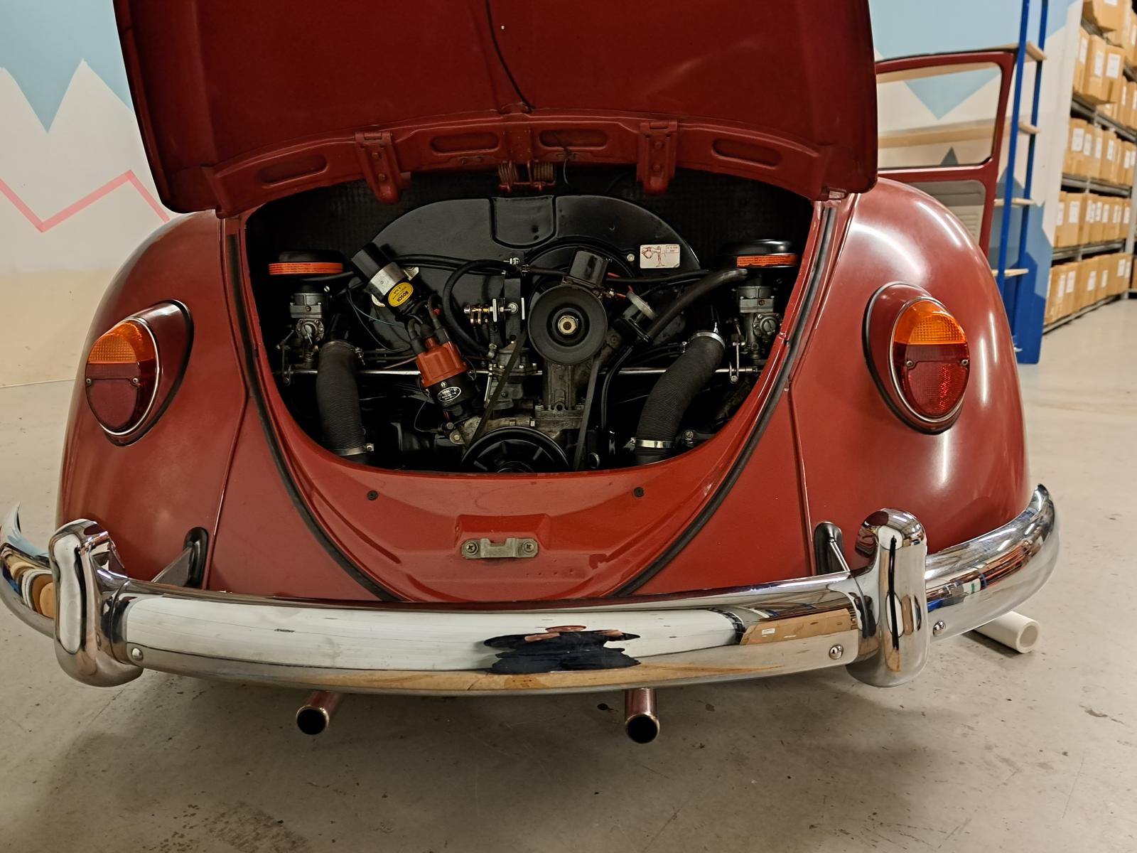

Hi,
I'm the new owner of a 65 bug. Unfortunatley the person I purchased from didn't know much about the motor. So asking a few questions here please.
It's numbers matching, so was a stock 1200 at some point.
It's running a 010 distributor, has a nicely engineerd dual carb set up by Reichert engineering. I think this is a German company, but they no longer have a website. Anyhow I think it's dual Solex 28's, custom manifold, with a balance pipe. The linkage seem to be very well made. Heads are stock for the year I think.
I checked valves, set timing to 32 at full advance, synched the carbs.
It runs quite nice, seems similar in power to my 1500, just has a little stumble on light to moderate throttle. Driveability is OK but it's a little go- dont go compared to say a stock 1500 that I was used to. I assume this is as the 010 doesn't have vaccum advance, so was thinking of trying to change to a SVDA, but not sure if I will be able to get a good vaccum signal from the carbs?
Also it has a non stock exhaust, no idea if it's any good, but it sounds great. I've attached a few pics.
So my questions if anyone can help are:
Other than pulling heads anyway to tell if I have bigger pistons?
With the Dual solex's would I get a good vaccum signal from them and if should I just get a SVDA?
Anyone recongnise the exhaust. It has a small pipe running from the exhaust port to the main exhaust body, no idea what that is for?
Thanks, Jake
Engine Bay
Exhaust
Wierd Tube from Exhaust port to Exhaust body (Circled in red)

PostPosted: Sun Nov 26, 2023 2:43 pm    Post subject: Re: Some Vintage speed questions Reply with quote
Tube id the heat riser for the stock manifold. You need to plug it when running dual carbs
Thanks Glenn, I think that is maybe what is was but it now goes from the Exhaust port to the centre section of the exhaust, I guess it was done that way rather than running to a heat riser since it doesn't have them. Thanks.

PostPosted: Tue Nov 28, 2023 10:13 am    Post subject: Re: Some Vintage speed questions Reply with quote
Pretty sure that’s a stock 40hp exhaust. That funny oval shape is sometimes linked to the “bastard” engine, but I believe it fits all 40hp. See if you can get a picture of the part number.
You definitely need the heat riser block offs, otherwise you are dumping lots of exhaust into your engine compartment.
