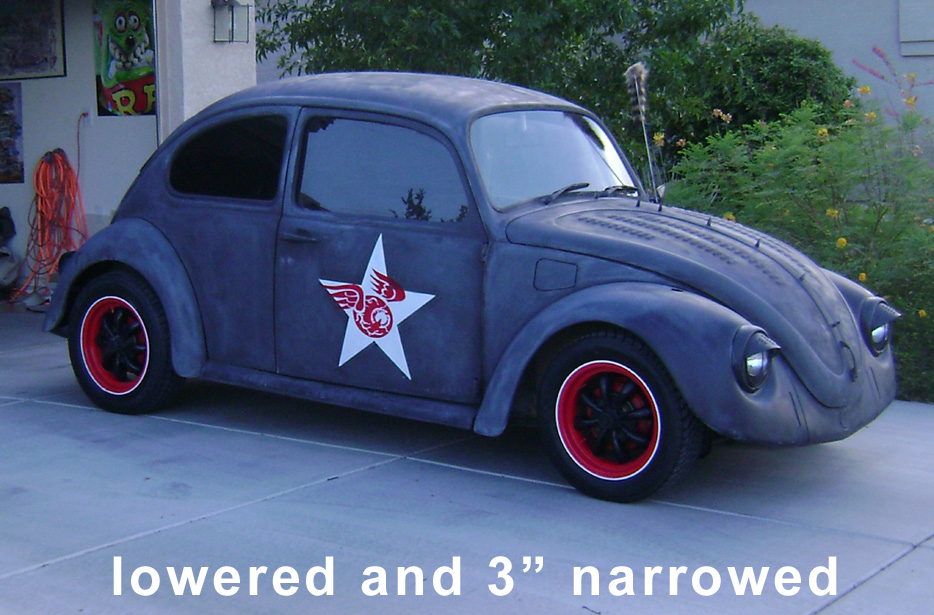

These are Empi 8's (15x5.5) on my '69.
185/60r15 fronts
195/60r15 rears.
I bought it with that tire and wheel combo, and I can see a cut to the right front rubber where the PO had it lowered but not narrowed so the tire hit the wheel well at some time. Ever since I put the narrow beam in I can turn to full lock now with out cutting anything.
