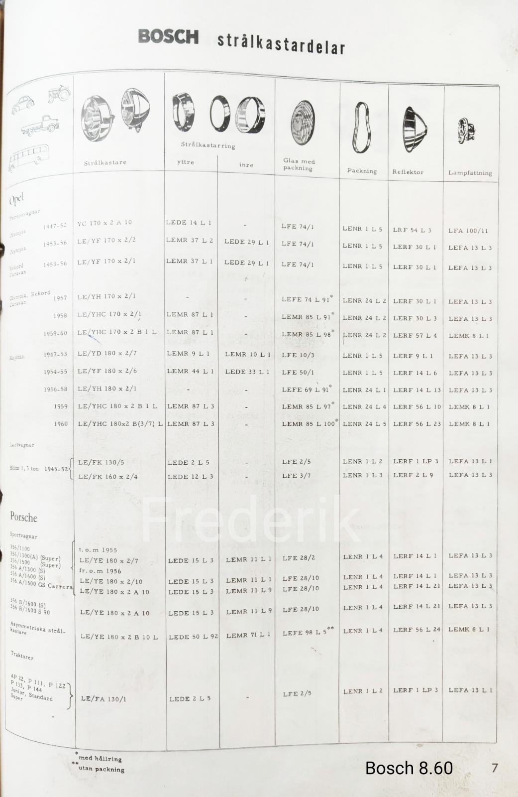

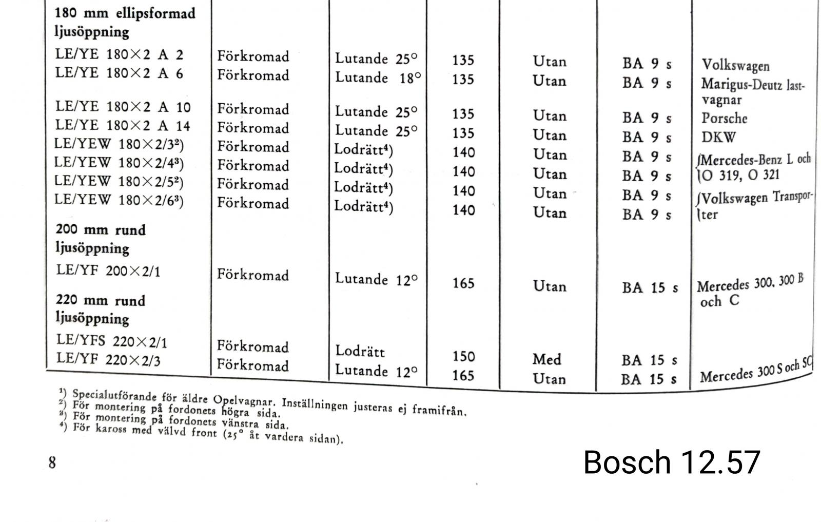

Just for sharing as I'm not a member on the registry, maybe not so mutch an answer to the topic. This is for the euro "fluted" symmetric (and I can continue in to the asymmetric if some one needs it) Bosch headlights. Info taken from Bosch literature from the 50's up.
1955 (1951-1955) all models
1956 "standard equipment" headlight and glass
"News from Bosch" november 1956. Glass LFE 28/10 sold as accessory for Porsche and vw if a long range high beam was wanted for fast driving on straight roads. (LFE 28/2 wider beam for curvy road driving).
1957
1960 different headlights 49-60, and as comparison VW headlights.
Note that the asymmetric headlight was for driving on the left side of the road back then in Sweden.
1959 asymmetric headlight
Parts Diagram. The drawing is for all types of LE/YE 180.. headlights and might not be exact. The two main difference for vw/ porsche Early/pre -56 headlights was the use of different chrome ring and bulb holder.

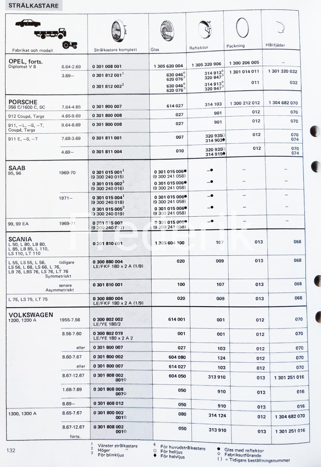

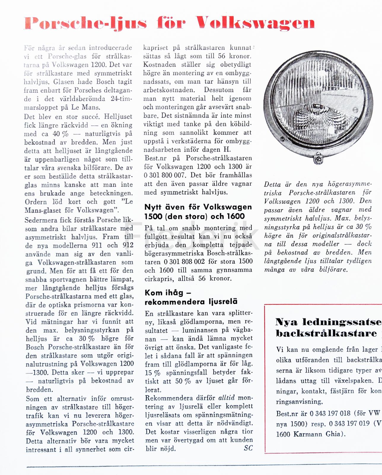

This is from an Bosch news letter (for Bosch dealers) talking about fitting "Porsche light for VW". Starting to reference that Bosch a number of years ago made a new symmetric headlight glass developed for Porsche and specificly for Le Mans. This was also sold as a accessory for vw and had 40% longer high beam throw. (Note: This would be the LFE 28/10 headlight glass). After that Porsche as other models got asymmetric headlights. The Porsche headlight is based on VW but again got a glass with longer range high beam, 30% than the normal vw. Order number is 0 301 800 007 for the complete headlight.
Asymmetric headlights and parts on Porsche and vw (right Side on the road driving). (The ..007 headlight listed as option for vw).

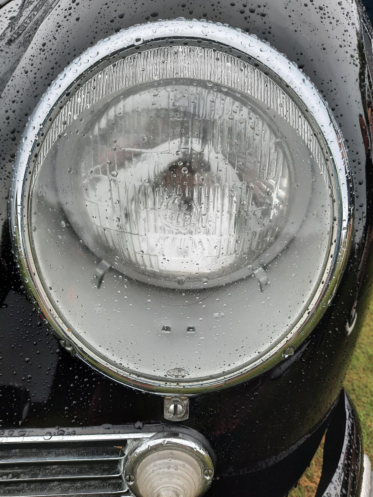

I'm mostly curious if the Continentals had the "faded" oval sealed beam headlight lenses used on 54-55 VWs.
This:

The 0 301 800 007 "Porsche asymmetric headlight" in my last post used the 1 305 614 027 glass also marked "4487" on the outside. I think this came out around mid 60's.
Unfortunatly the Bosch literature I have 61-66 doesn't list Porsche parts. But as noted in the 59 and 1960 literature porsche/vw in the beginning used the same asymmetric headlights. For driving on the right side this would have been LEFE 98 L 4 (1 305 604 080) glass. This glass had the 4430 on the outside. You can spot them as they have the fluted oval in the middle, just like symmetric headlights in addition to the "asymmetric fluting".
There is also a 1 305 614 026 glass with "4474" on it. I havn't found it in any of Swedish literature, but it almost looks like the "dual" asymmetrical headlights you could tune the light for LHD/RHD?
Parts for vw (I included a -66 list as it has both old/new Bosch part numbers and left "V" and "H" right side driving options).

I'm interested to know what you find out so please post the information here.
This:
Yes, with the small Hella logo as pictured--1953-early 1956.
This:
The photo Everett posted here is EXACTLY the same. Simple, clear glass with a small Hella logo at the bottom and a faint oval line in the center of the lens. Now I just need to find two in good shape!
