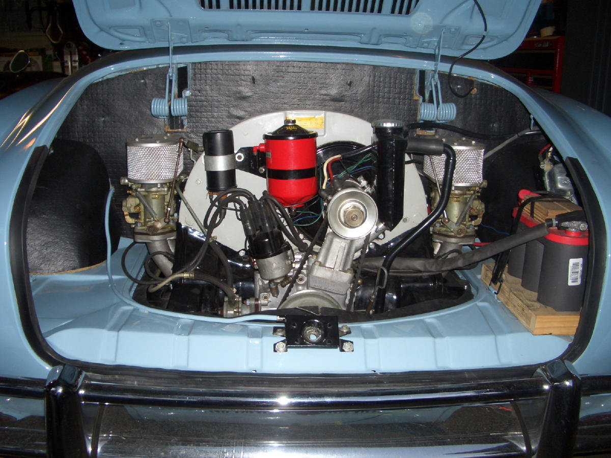

The 356 engine I am looking at is the quiet 60hp, with the 32 NDIX Zenith carburetors and large air filters.
Your answer are very interesting. Mike, do you any pictures to show for the engine in your '63 ?

PostPosted: Mon Feb 19, 2007 10:55 am    Post subject: Reply with quote
I will snap a couple of pictures and post them tonight.

PostPosted: Mon Feb 19, 2007 7:10 pm    Post subject: Reply with quote
Here you go:
https://www.thesamba.com/vw/gallery/pix/331925.jpg
https://www.thesamba.com/vw/gallery/pix/331926.jpg
https://www.thesamba.com/vw/gallery/pix/331927.jpg
Mike

PostPosted: Tue Feb 20, 2007 11:54 pm    Post subject: Reply with quote
Really interesting pictures from Mike and Henrik website both.
Mike, would you have pictures about your muffler fitting and mods ?
