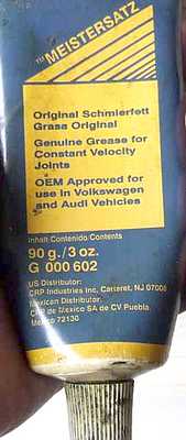

I'm sure others will disagree with me, but wherever I've needed to use actual grease, I've chosen the same stuff as VW used for CV joints, moly-added grease.
which is pretty much the same stuff as this (assuming this is still around, I took this photo a dozen years ago)
