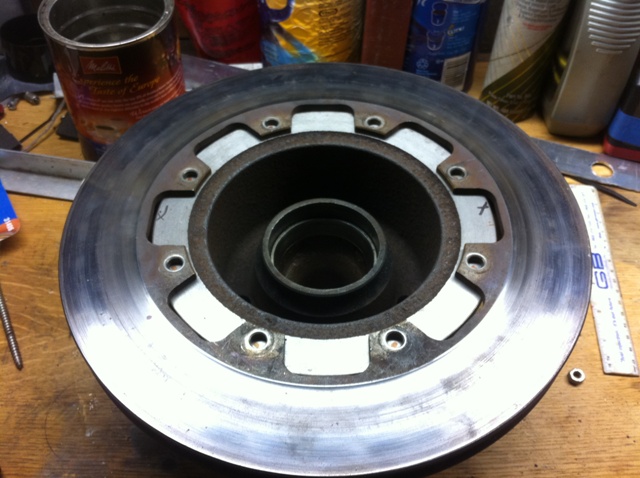

I got this far. The disc is a used one off my race car. I cut down a stock vanagon disc/hub and this was a far as I got. The plan was to use an aftermarket caliper from the performance industry. I have a Syncro now, so I don't know what I am doing. The replacement discs are cheap. Look over at Coleman Machine for an idea of cost.
Syncro and 2wd front hubs are complete different.
Looks great for a 2wd.

I thought the poster was asking about an early 2wd vanagon. Yes, this would only work with an early vanagon 2wd, but is a ways off from being on the road. I'd like better brakes on ours, but I have had syncro fever off an on since I got ours back on the road. Now that I have Syncro, that opens up a lot of options that I did not have before.
Right on.
Just verifying that a turned down 2wd setup will not work on a Syncro.
