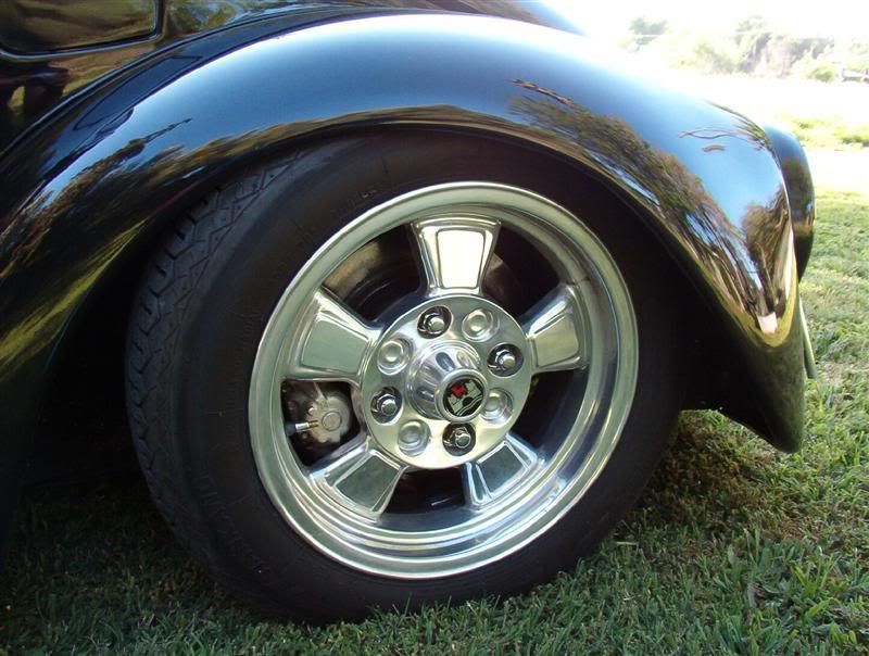

JDGas
Joined: June 23, 2004
Posts: 1233
Location: So. Cal/Montana
JDGas is offline
PostPosted: Fri Mar 30, 2007 2:44 am    Post subject: Reply with quote
I bolted a set of Rivs to a drop spindle'd, disc brake '68, and had only the slightest bit of clearence. You couldn't drop a credit card thru there, but they did clear. Here is the only picture I have on hand of it. And the car just sold to Nebraska, so I can't get any better pictures.

PostPosted: Fri Mar 30, 2007 6:45 am    Post subject: Reply with quote
I had the same problem. If your RIVS are original, smooth spoke style, they'll hang up on the caliper (or the rim, with a lowered spindle). The repros with the flat faced area are less of a problem, usually fit if they're the newest version, but not always. There were two calipers used, ATE and Girling.
Spacers will work for clearance, but the added stress on the rotor hat, lugs/bolts. and wheel bearings will be too much over the long run.
I ended up going with a different (Sprint Stars) set of wheels.
