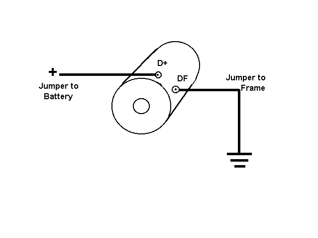

Replaced the generator in my 73 standard, ran fine. Parked it for about a week. Now the generator light comes on, and when I checked the generator, sparks are coming out of the opening where the copper coil and the brush touches it. Wired exactly the way the old one came out and polarized it by grounding the field wire and touching the battery wire to the D+ wire at the rgulator. Any suggestions?

u are getting a ground some where . I.G.the wire or the coil is touching a piece of metal it should not be

Have you been to Speedy Jim's Aircooled Electrical Hints?
Testing the Generator:
Polarizing the Generator:
It sounds like you did everything corrently. Shocked
