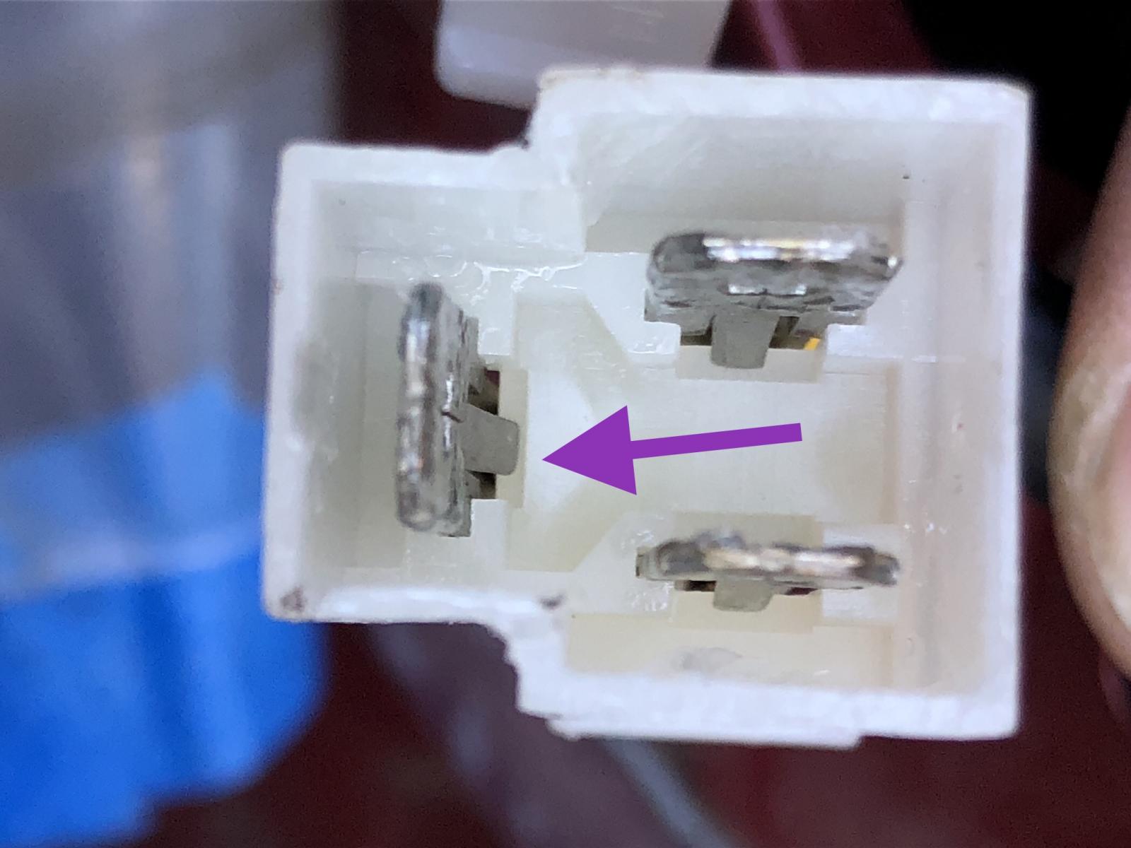

My rebuild of the power lock actuator did not last long. I finally admitted defeat and bought a new actuator. The available actuators are Eurovan actuators, and don’t come with the plug to attach to the Vanagon. So you can either cut the Van wiring, attach spade connectors and then attach them to the pins on the new actuator, or get the pigtail adapter that converts to a Vanagon plug.
After installing the new actuator, I still had problems. The locks would lock together, but I still had unlock cancelling, returning to the locked state. So frustrating!
I tore everything apart and rechecked all my wire continuities (it helps to have alligator clip leads and a multimeter with an audible continuity: I have one that I like from iFixit for about $30-35). Also: a diagnostic point here: when checking the wire continuities, open and close the door a few times to see if the connection falls off anywhere (a wire may only be intermittently severed).
I noticed that some of the wires in the plugs were loose. The retaining pins on the terminals were flattened & can be removed and bent back to lock into the plug housing (see photo with arrow at retaining pins):
This is a great time to use dielectric grease on these connectors as it gets pretty wet inside the door (which is why the actuators have drains).
Finally, I unplugged the harness on the new actuator and realized that it may have been on upside down (either the person who attached the pigtail didn’t do it right or I switched it when inspecting the new part). The brown ground wire goes down. I’m pretty sure this was the culprit: put it all together and locks work great now. _________________ 1989 2.1L Vanagon Westy, Automatic, Titian Red |
