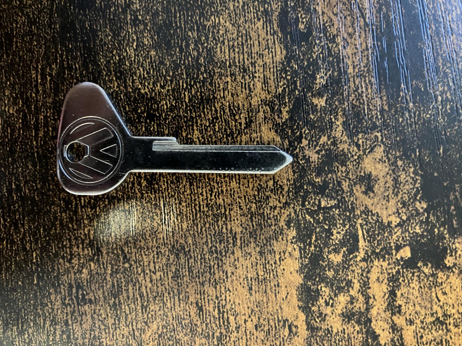

First time poster. Thanks in advance for helping a new guy.
Does anyone know why my new "R" blanks don't push all the way in on my 1974 bus? I have one old key which works fine -- it is stamped V-29, and R, and it's from Curtis Industries. I ordered two R blanks from Wolfsburg West. When I push the WW keys into the locks or ignition, they stop about an 1/8" shorter than the old Curtis key. They stop about where the key grooves stop. The photo shows that the grooves are different lengths between the Curtis and new WWs. Did WW send me the wrong blanks? Why won't they go all the way in?

Wrong forum. You should probably post this in the Bay Window Bus Forum.
As for the R profile key blank with VW logo shown in your post, I purchased a set of these style blanks years ago and paid a local reputable lock shop to cut new keys for my '74 Thing and had no issues whatsoever.
