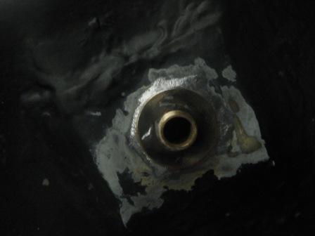

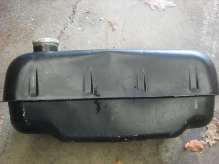

Hi, I searched but still didn't find the answer.
I have a tank which I believe is correct for my 57, but the PO had put a pipe on the outlet instead of the correct valve. I just remove the abortion pipe (brazed a pipe to a nut) and my new valve from WW will not fit on the threaded portion coming out of the tank. How is this suppose to fit in? Is it just a threaded nipple?
A quick answer would be most appreciated as I am tanking the tank to be cleaned.
Thanks

PostPosted: Mon Jun 04, 2007 11:21 am    Post subject: Reply with quote
The fuel reserve should have a reverse threaded nut on it. You remove the nut off the valve. Then sandwich the nut between the tank outlet threads & the fuel reserve valve. When you turn the nut, it'll draw both the outlet & the valve together- Sort of like a heim joint.

PostPosted: Mon Jun 04, 2007 11:31 am    Post subject: Reply with quote
RareAir,
I see what you mean. But the thread on the tank is smaller than the thread on the reserve valve nut. I'm thinking that the PO put in a different nipple. Or is the thread on the tank welded or molded as part of the tank?

PostPosted: Mon Jun 04, 2007 12:48 pm    Post subject: Reply with quote
VW originally press fit & spot welded the threaded outlet into the tank.

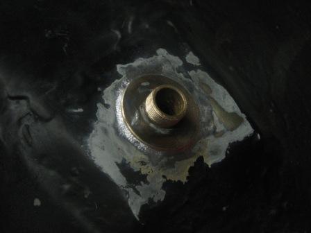

PostPosted: Mon Jun 04, 2007 5:27 pm    Post subject: Reply with quote
Thanks, I took it to the shop for an estimate. Unfortunately the guy that gives the prices wasn't there but the worker guessed $200-250. That's to clean, coat the inside and possibly fix the fitting (wasn't sure about the fitting though).
I got home and wire brushed the paint from the fitting and I see what you mean. The threaded outlet is definetly not correct. I am getting a lot of parts this weekend and I think that there is a tank in it so I will see what that one looks like. Hopefully it will be in better shape or at least have the correct fitting (maybe I can make one out of two).
Does the price given seem about right to boil out and coat the tank?
Any other suggestions are welcome. I just want the correct valve to work as designed, I'm not too concerned about it being 100% correct as this will not be a show car.

PostPosted: Mon Jun 04, 2007 6:33 pm    Post subject: Reply with quote
$200-$250 seems high. You can buy a restored tank ready to go for less than that
